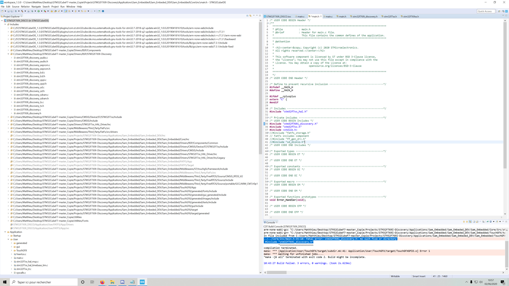

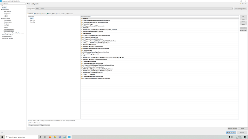

Ok so despite having added all the include paths to the properties of my project, #include "stm32f769i_discovery.h" doesn't work. I get the error : ../../Core/Inc/main.h:35:10: fatal error: stm32f769i_discovery.h: No such file or directory
#include "stm32f769i_discovery.h", but my .h file is present in the included directories on the left of Cube IDE.
Has anyone had this issue?
[edit] Seems, the issue was that i didn't add those directories to the c++ part. But now i'm getting an error without knowing where it comes from:
collect2.exe: error: ld returned 1 exit status
make: *** [makefile:70: STM32F769I_DISCO.elf] Error 1
[edit2]
After regenerating the project, the error was more detailled, i'm missing
-l:libtouchgfx-float-abi-hard.a
[Final Edit]
I added a folder in the original path to be placed exactly as the example, but the library path wasn't updated, so i had to do it manually. (If someone has the same issue one day :X )
