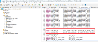

However, I did check the STM32H7 repository & tried some application like CDC_standalone:
#define USB1_OTG_HS ((USB_OTG_GlobalTypeDef *) USB1_OTG_HS_PERIPH_BASE)
#define USB2_OTG_FS ((USB_OTG_GlobalTypeDef *) USB2_OTG_FS_PERIPH_BASE)
In other words, I am looking for some example with
#define USB1_OTG_FS ((USB_OTG_GlobalTypeDef *) USB1_OTG_FS_PERIPH_BASE)
There are no such examples, because ST have changed the naming convention. USB controllers now are named USB1, USB2 and so on instead of "FS" and "HS". Some of USB controllers are capable of both modes. The actual mode is set somewhere in the initialization code.

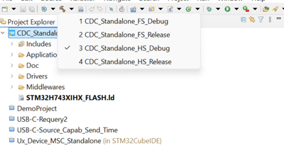

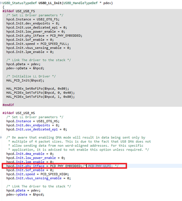

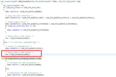

When building your project, you can choose which USB instance to be used and in which mode
If you would like to use instance USB1_OTG_HS in full speed, you can simply reconfigure here the project to work in FS, make sure to initialize the interface as follows
hpcd.Init.phy_itface = PCD_PHY_EMBEDDED;
hpcd.Init.speed = PCD_SPEED_FULL;
