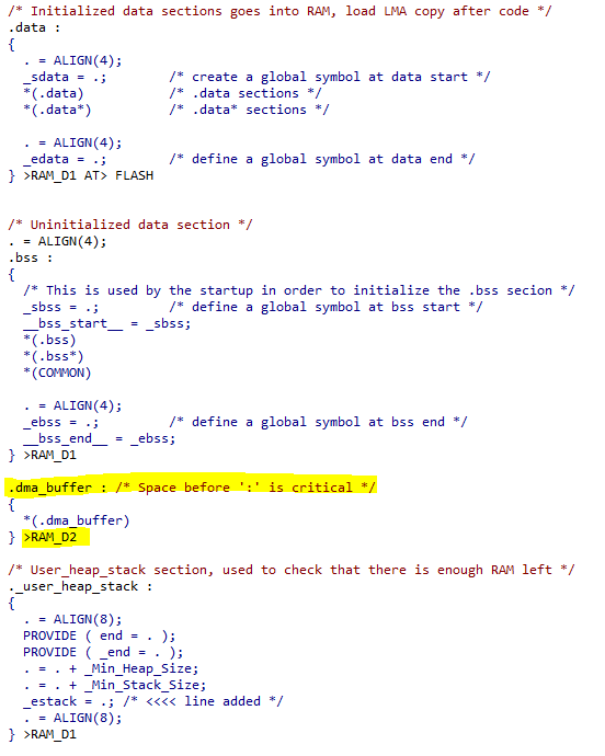

I am already allocating the buffer in to D2 (0x30000000), which I think should be right, and I haven't enabled the cache yet, for remaining all nonvolatile memory allocated in section D1 (0x240000000).
Figure-1 updated STM32H743ZITx_FLASH.ld

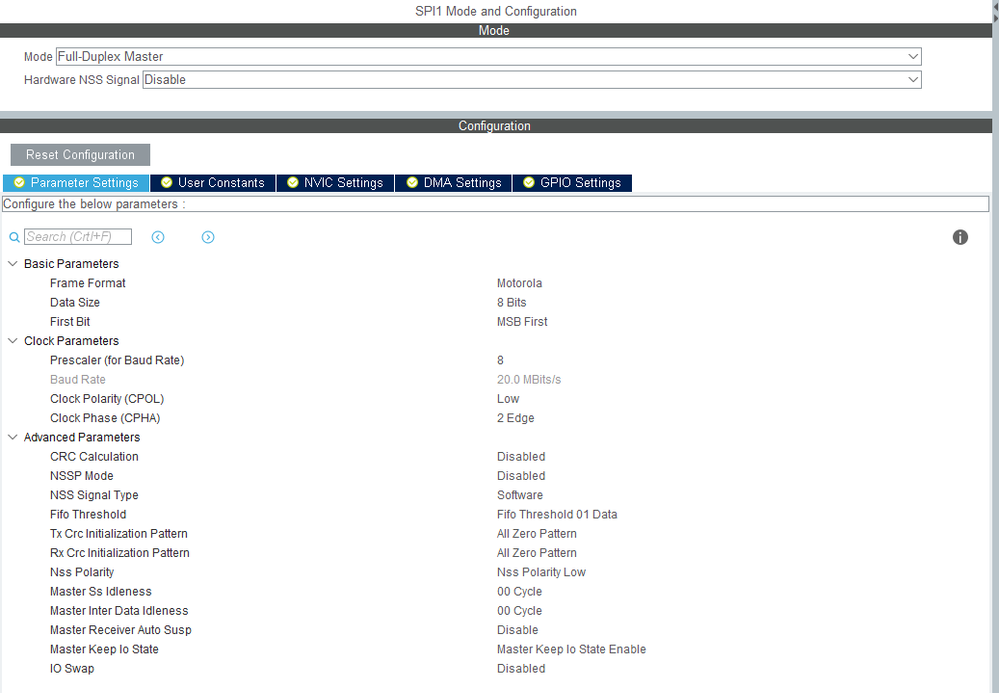

Figure-2 Used SPI configuration in cubeMX:

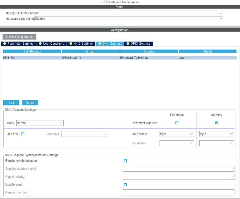

Figure-3: Used DMA configuration in cubeMX:

Observed DMA generates interrupts two times, one when half of the buffer is received and another one when the second half is received (whole).

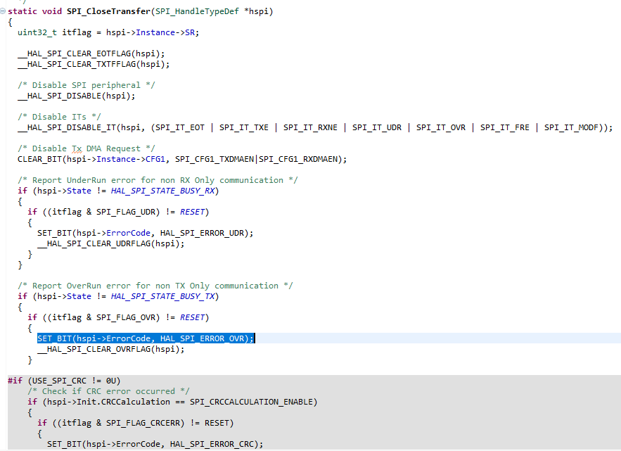

But always getting SPI_ERROR_OVR (see Figure-6)
Figure-6

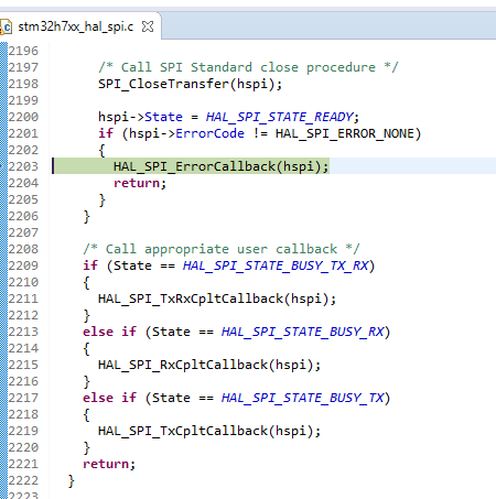

This will eventually calls HAL_SPI_ErrorCallback(hspi) and return instead of HAL_SPI_RxCpltCallback(hspi)
Figure-7
Same experiment works well with STM32F7 but always getting OVER RUN Error in STM32H7.
Means Configuring SPI peripheral to SPI1, using DMA1 and reading data in normal mode, eventually generates the both HT & CT interrupts for DMA, but in CT it always generates the SPI OVER RUN error instead of calling
