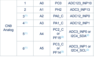

2024-03-27 9:06 AM
Thanks for your reply and suggestions.
you want best resolution , the H735 has 16 bit ADCs , but you use the 12 bit ADC --- why this?
I'm using the dev kit initially which does not have ADC1/2 on all of the Arduino header expansion pins. Where I am using 4 thermistors I chose to use ADC3 so I could have them on the same ADC number. I will retest using a few of them on ADC1 and see how that improves the sampling. The pins available are as follows:
