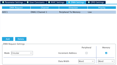

DMA settings for ADC1 are...

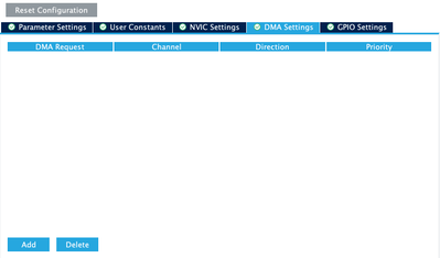

...and DMA settings for ADC2 are empty, so only one DMA channel is used:
I'm lost and the HAL documentation regarding dual regular simultaneous mode is almost non-existing. Any ideas ?
