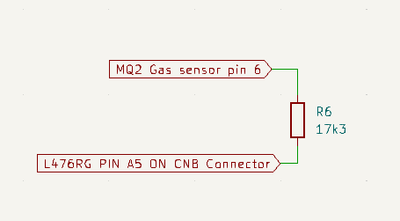

I'm multiplying it by 5 because I am using pin A5 on the L476RG to read the value of the gas sensor, and that board is plugged into my computer and powered off of 5V, I have no way off reading directly off of my PCB bc I messed up with the pin configuration for USART and chose a UART IC instead. This was from reading the pinout incorrectly on the datasheet.
Right now I have a wire soldered on from my gas sensor to a breadboard, with both grounds of the PCB and L476RG connected, and the analog pin from the L476RG connected after a resistor:
I know this isn't exactly the best way to do this, but I don't see any other way since there's no room on the pads of the MCU to solder a wire directly to it. I'm also assuming the cable length doesn't help.

Again, the ADC does not "know" about your 5V supply to the gas sensor.
The ADC works in that way that it outputs value which represents the ratio between input signal and the ADC reference voltage, which is connected to VREF+ pin of STM32 (in small packages VREF+ is connected internally to VDDA).
So I read the schematic of the L476RG, and you are correct it is connected to 3V3 as well. Its unsurprising since most MCUs operate at that voltage range anyway.
