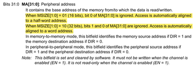

> DMA start addresses require 32-bit word alignment, regardless of transfer size.
They only require 32-bit word alignment if the accesses are 32-bits. If 16-bits, only 16-bit alignment is required. And the peripheral does this automatically whether you like it or not:

I would recommend the reference manual here, and I think almost all STM32 MCUs share this properties.

2025-02-19 5:44 AM
