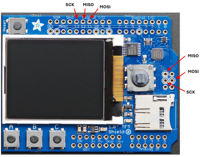

I found similar problems working with the Adafruit 1.8" V2 TFT expansion board.
First the display backlight defaults to off. Brightness is controlled by a I2C "Seesaw" chip. But most references to this device address are incorrect. The correct I2C address is 0x2E. Although one can force full brightness of the display by shorting R1 to GND.
The joystick is also controlled or read via the seesaw device, so if you want to use the joystick you'll need to communicate with it via the I2C bus.
Another problem with the Adafruit 1.8" V2 TFT board is that it is missing SPI signals (SCK, MISO, MOSI) to control the MicroST memory.
Install wire from: J_SD-4 (Adafruit display) and CN5-4 (MOSI) Arduino connector
Install wire from: J_SD-3 (Adafruit display) and CN5-6 (SCK) Arduino connector
Install wire from: J_SD-1 (Adafruit display) and CN5-5 (MISO) Arduino connector
Note: LED2 is currently driven by PA5/D13 (CN5-6) configured as GPIO. PA5/D13 (CN5-6) must be reconfigured as SPI1-SCK.
I was finally able to resolve all the issues with this board and got everything working. Although I also had to modify the code to get the proper display orientation for text, graphics, and picture. Also, the text and graphics color had to be modified.
