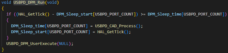

I am building a USBPD sink with reference to the UM2552, but in the sample code on page 16, it seems that the ")" corresponding to the IF on the 9th line has disappeared, is this a typo? Also, is there a correct example somewhere?

Hi @Sodag.1 ,
The USBPD_DPM_Run function differs depending on whether you are in RTOS or bare metal system.
In case of RTOS, the USBPD_DPM_Run function is used to start the OS and USBPD_DPM_UserExecute is the user application function called inside a dedicated task.
void USBPD_DPM_Run(void)
OS_KERNEL_START();
}In the case of bare metal, the USBPD_DPM_Run function is an infinite loop that calls the various entry points of the USBPD stack + USBPD_DPM_Users (for the user application)

}A standard USBPD sytem must handle different activities
Please could you provide us more detail about your issue ? and the type of application you want to generate ?
