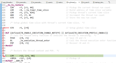

I debug the project and find that the problem is in tx_thread_schedule.S . It seems that the program did not run under this condition:
#if (defined(TX_ENABLE_EXECUTION_CHANGE_NOTIFY) || defined(TX_EXECUTION_PROFILE_ENABLE))
even if I already define TX_EXECUTION_PROFILE_ENABLE in tx_user.h. That makes me confused. because the .S includes tx_user.h .
However, I directly define TX_EXECUTION_PROFILE_ENABLE in tx_thread_schedule.S . The problem is solved. But it's dangerous because the changes disappear when I use stm32cubemx to regenerate the code.
So how can I do to solve it?

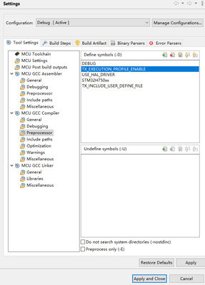

since the flag TX_EXECUTION_PROFILE_ENABLE is being used in ".S" you'll need to add that define in the assembly preporcessor rather than the C/C++ one.

Instead of defining TX_EXECUTION_PROFILE_ENABLE in tx_user.h, you can define it project-wide in STM32CubeIDE under C/C++ Build settings> processor sections> symbols, you have to re-apply that after regeneration.

thank you for your reply. so quickly. I do as you said.
I notice the TX_EXECUTION_PROFILE_ENABLE is redefined when i build the project, because I don't delete the define in tx_user.h. but I decided to continue.
Unfortunately, the result is the same problem. tx_thread_schedule.S didn't run under
I don't know where I make a mistake. Sad...
Anyway, I don't change tx_thread_schedule.S . it was automatically generated by stm32cubemx. And the path of tx_user.h also was added by stm32cubemx. Maybe the problem comes from the setting about gcc or else. I don't know.

Thank you so much. Now I know what my problem is. I confused GCC Assembler with GCC Compiler.
when I add TX_INCLUDE_USER_DEFINE_FILE macro and include path in GCC Assembler. The program runs well. The macro and include path in GCC Assembler need to be added manually by programmer. They don't like the ones in GCC Compiler where they are automatically added.
