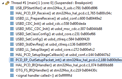

* @brief Data received over USB OUT endpoint are sent over CDC interface
* through this function.
* We get here when there is some OUT data (OUT = PC to target). That data is
* loaded into cdc_receive_temp_buffer[64], supplied to us here as "buf".
* This is the call flow: https://peter-ftp.co.uk/screenshots/202209065715674317.jpg
* Data is then copied into our circular buffer cdc_receive_buffer[1024].
* No more data can be sent by PC until USBD_CDC_ReceivePacket gets called.
* This function is called by an ISR so no need to disable interrupts.
