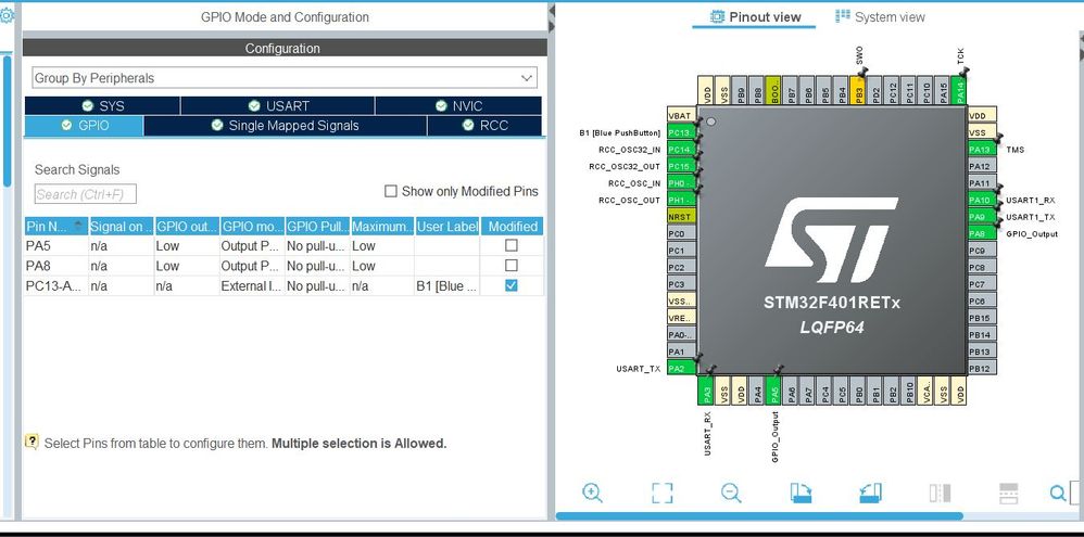

2023-07-07 4:40 AM - edited 2023-07-07 5:15 AM

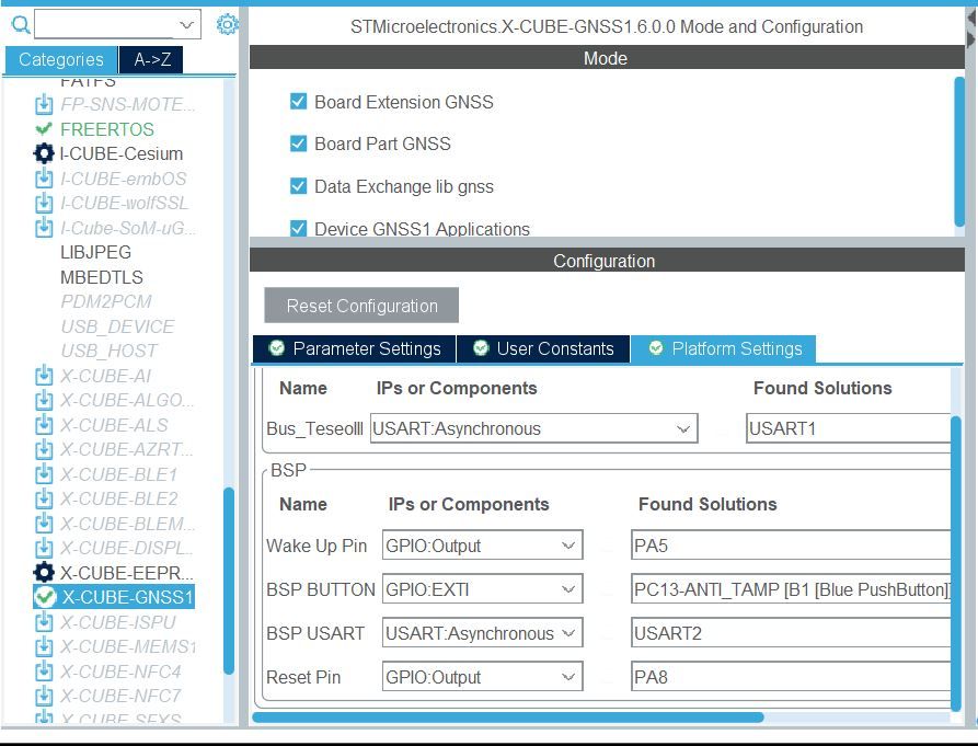

thank you for the answer. Regarding the settings - I must copy ports, interfaces settings and middelware package settings (X-CUBE-GNSS1 - change for VIC3DA, without using RTOS - RTOS disabled), according to set pictures below?
- pionout and port settings for connection with X-NUCLEO-GNSS2A1 board:

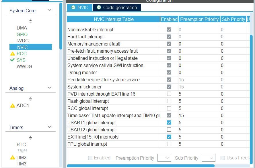

- interrupts (USART):

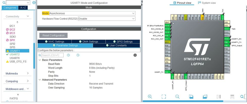

- USART1, change BR to 115200:
- settings of GNSS1 package, we are disabing RTOS (here is still enabled, thig to change):

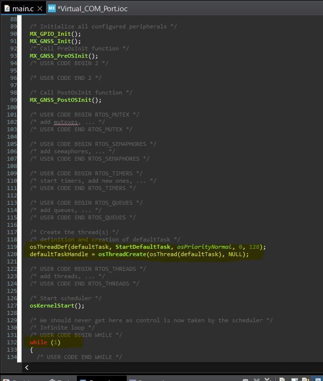

And the last needed thing - to use two mentioned functions (Consumer and ParseTask) - I must comment these lines marked as red in main.c --> main(), as placed below (if I want to use/modify ready example for L476 0 GetPos - from package, it has RTOS inside) :
If something is missing, please correct me.
regards, Paul

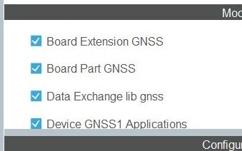

Few more things, can you explain mi how to use these two functions (TeseoConsumerTask, ConsoleParseTask)? Where put them, in main()? They are associated with thread, so where should I put a comment to make the unassociated? And the last thing, which extensions should be chosen:
- all?

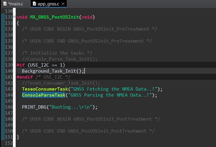

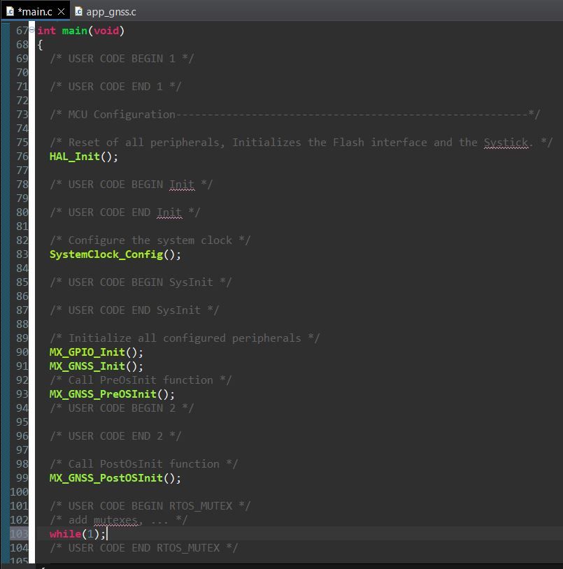

Thanks for an answer. The best way, I think, the fastest one, is:
(above - commented _init functions and added TeseoConsumerTask("GNSS Fetching the NMEA Data..!"); and ConsoleParseTask("GNSS Parsing the NMEA Data..!"); )
(above - main() with added while(1);
It compiles without errors, I'll try it in the evening and send fedback - if it works or not.
2023-07-10 10:42 PM - edited 2023-07-10 10:48 PM
Hallo. Unfortunatly the solution you adviced doesn't work with NUCLEO-L476 and NUCLEO-F401 - I took code from X-CUBE-GNSS1 examples with RTOS (so, the configuration was good), there are these functions implemented, so I disabled _init and added TeseoConsumerTask and TeseoParserTask - without success.
