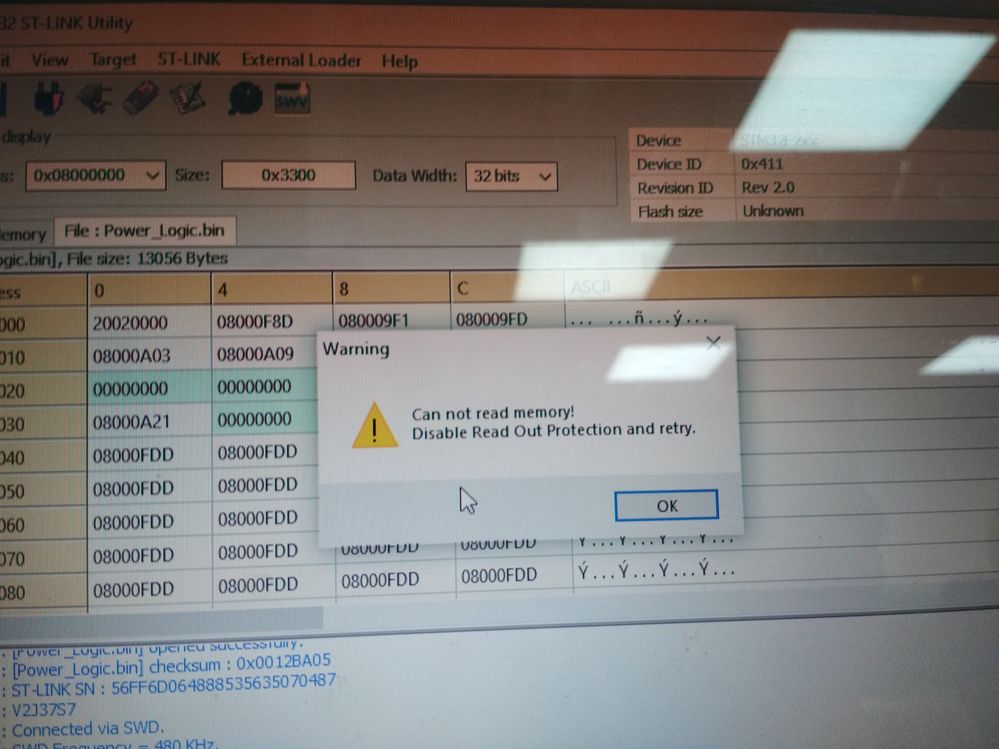

The warning messages says it can't read memory because RDP is enabled. Disabling RDP can be done within the option bytes (Target -> Option Bytes). Set it to level 0 and restart.
2020-12-30 9:53 PM
hello, thanks TDK ,for your time and reply. I tried doing it with stm utility but I am unable to modify it.it shows same warning again. Any help would be great.

I checked from my side and I have no problem, it works for me.
It's strange that you have the Flash size: Unknown !
As you see in the below screenshot, the flash size is 1MBytes.
So, please check that you have the correct dev ID, rev ID, flash size from the reference manual.
