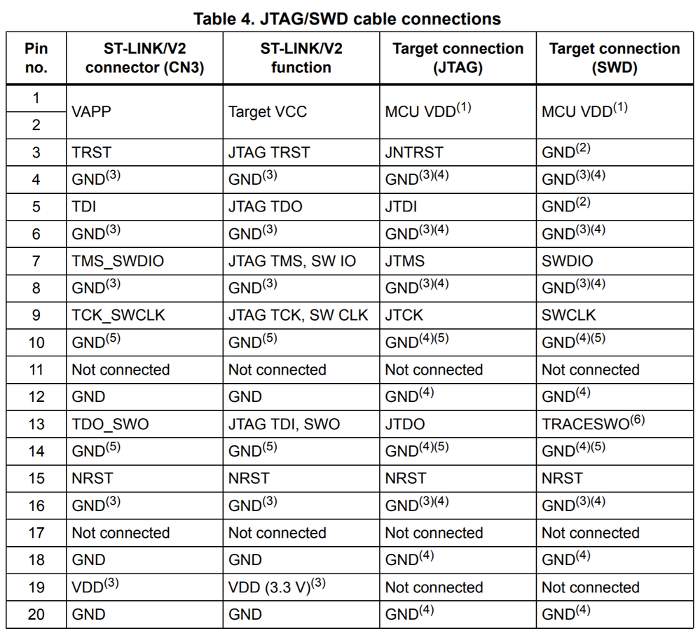

Okay, so let's go to the documentation page:
https://www.st.com/en/development-tools/st-link-v2.html#documentation
And open up the user manual:
https://www.st.com/resource/en/user_manual/dm00026748-stlinkv2-incircuit-debuggerprogrammer-for-stm8-and-stm32-stmicroelectronics.pdf
And look at the pinout for the 20-pin connector:
There are no pins dedicated for a VCP connection because ST-LINK/V2 doesn't include this feature.
The newer debuggers such as STLINK-V3MINI and some ST-LINK/V2-1 debuggers do have this feature.
https://www.st.com/resource/en/technical_note/dm00290229-overview-of-stlink-derivatives-stmicroelectronics.pdf
