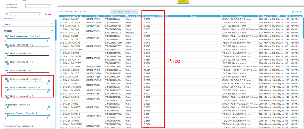

2024-11-08 1:19 PM - edited 2024-11-08 1:49 PM
1) I really don't have the price in mind but you can go to the stm32MCUfinder and filter, search for those MCUs and select the price for the 10K unit. You can have it in order (increasing or decreasing).

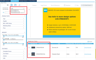

2024-11-08 1:39 PM
The part suggested by @STOne-32 is the STM32H7B0RBT. It is supported by Cube Tools. But as he said there is not any board for this MCU.
Best Regards.
STTwo-32

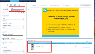

2024-11-08 1:46 PM
@RongShengWang wrote:
Is there any applicable Evaluation Board for us to try first?
Many choices for the board:
Eval and Discovery:
Nucleo board (cheaper):
You can use CubeMx and CubeIDE.

2024-11-08 1:57 PM
Can we use this one NUCLEO-H723ZG?
Thanks,
Rong
2024-11-08 2:02 PM - edited 2024-11-08 2:05 PM
Yes you can. If you will use an STM32H723/33 for your project.
Best Regards.
