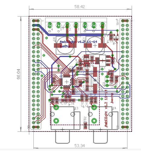

I want to create PCB on top of which I will be able to plug in the Nucleo-144 board. What should I order, can anyone share advice? I tested that board's pitch of the bottom pins is 2.54 mm (because 2.54 mm ribbon cable fits, UM doesn't mention ''pitch'' word nor shows this on the mechanical drawing). The PCB for discovery board that I need to edit is following:
Pitch between the holes on left and right is correct, 2.54 mm. But what part should I use to be able to plug in the Zio pins that are on bottom of Nucleo? After I change PCB to have 2x10 (CN7), 2x8 (CN8), 2x15 (CN9), 2x17 (CN10) series of holes, to match Zio. Is my approach overall correct? I'll be transmitting DCMI data.

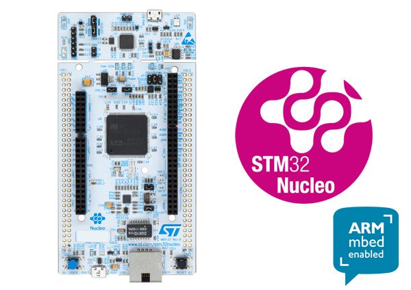

Nucleo 144 looks like this:
The 4 black female pin headers around the QFP144 are compatible with Arduino Uno (2.54mm pitch) except that more signals are accessible by doubling the rows. (they mismatch from the presented bottom board layout).
I guess the unpopulated left and right dual row connectors are called ''MORPHO'' connectors as in the Nucleo 64.
In both cases classical dual row 2.54mm pitch headers.

I am not sure we are on the same page. We are soldering the SSW-136-01-T-D on our base board and plugging the Nucleo-144 directly into our matching cn7, cn8, cn9, cn10. Alignment is a pain with the left pair since ST preferred matching someone else's setup, instead of looking past that. At this stage we are not using the outside double row of holes on the Nucleo - cn11 and cn12. We are not yet shipping in volume. Stage 1 is getting a part that is available and works. Are you in North America?

Yes this sounds like what I want to do. Use the pins at bottom, which are basically ST Zio, but male connectors, not female as on the top. The outer double row holes are ST Morpho as far as I understand and I'm not using it. Counts of CN7, CN8, CN9, CN10 are 20 + 16 + 30 + 34 = 100, so I think I can order the
/external-link.jspa?url=http%3A%2F%2Fwww.newark.com%2Fsamtec%2Fces-150-01-t-d%2Fboard-to-board-connector-dual%2Fdp%2F15P1321
and cut it into 4 parts. I thought I will be able to use the mechanical drawing from User Manual to set distances between connectors for CN8 & CN9 and alse between CN7 & CN10, but surprisingly the drawing doesn't specify that distances. I tested that I could connect 2.54 mm ribbon cable across CN8 & CN9 so it looks it's like there is just 'missing' pin. But I will also have to somehow measure the distance between CN7 & CN10, maybe you know the value? I'm from Europe.2017-02-07 7:07 AM
