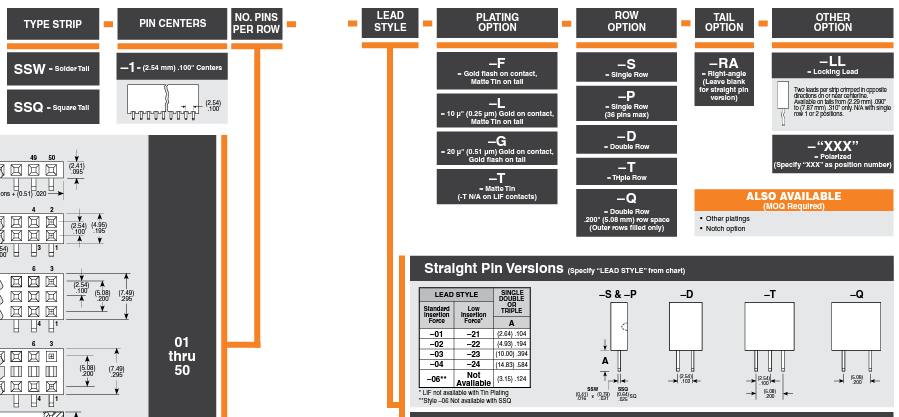

I looked on my Nucleo L5 BOM ( https://www.st.com/resource/en/bill_of_materials/mb1361_bom.zip )
and found some Samtec SSW-1xx-23-x-D.
The datasheet is here: https://suddendocs.samtec.com/catalog_english/ssw_th.pdf
and the "23" in the part reference indicates some low insertion force 10mm pins

For the NUCLEO-144 boards, check out Samtec TSW-135-09-G-D. It has the same long pins as the NUCLEO-64 boards. Style "09" defines pin length:
5.84mm (.230") above connector
2.54mm (.100") connector itself
10.16mm (.400") under connector
Assuming board thickness of 1.78mm (.070"), length of pin under the PCB would be 8.38mm (.330")
