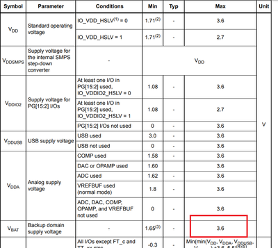

According to the datasheet there is no constraint regarding this point VBAT vs VDD:
VBAT max = 3.6V and not VDD.
