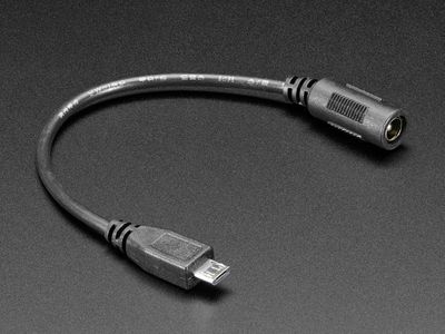

You could even power the board via the ST-Link USB connection using a USB power supply or power bank.
eg, via a lead like this:
USB specified 5V power - so you just need a 5V power supply.

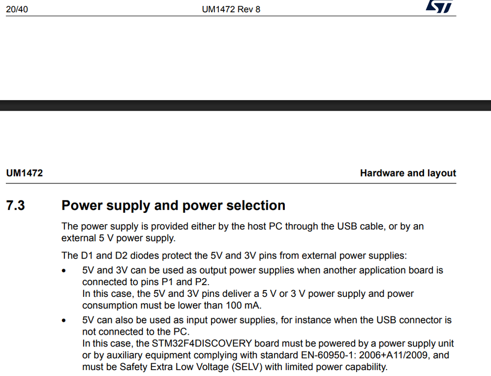

You need to read the User Manual for the Board:

Hello @cockatoo
You need to configure your board to be powered from an external power supply
you can refer to the section 7.4 of this user manual if you have the LQFP144 package
