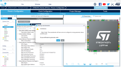

2025-04-06 3:00 PM - edited 2025-04-06 3:02 PM
Hi thanks!
Im trying to generate the code from the same mx version that used in the example:
MxCube.Version=6.5.0
And getting the following warning:
Can i just ignore it?
Thanks alot!
2025-04-07 11:23 AM
Sorry if the explanations were not clear enough. When you use a ready example - just build the example _as is_ and run it. Cube is not yet known to generate a project with ETH that work without manual editing :(
It is more complicated that it should be :(
