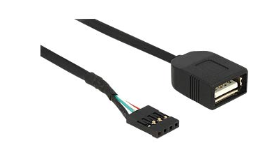

or something like this:
https://www.reichelt.de/usb-pinheader-buchse-auf-usb-a-buchse-40-cm-delock-83825-p163112.html?&trstct=pos_8&nbc=1
+ just solder the wires to the correct pins !
