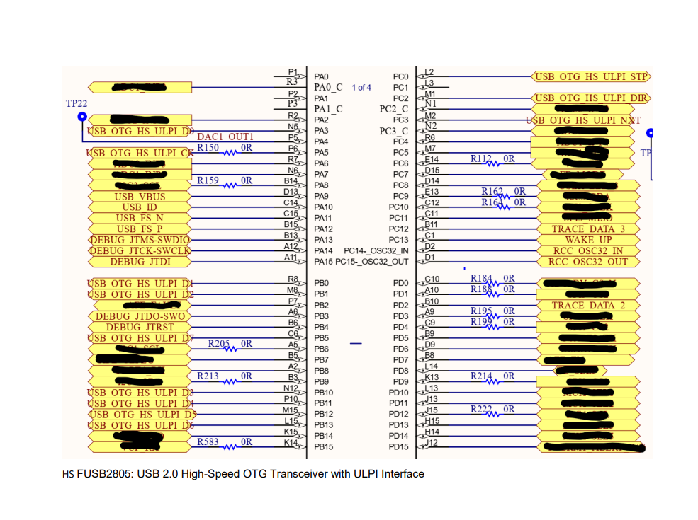

I am working on STM32H745IIK controller.I am enabling the FS and HS USB configuration.The pin mapping that I enable is correct or wrong can you please guide me.I am sharing its pin mapping can you please just help to corrects its pin mapping.0693W00000HqGzmQAF.png0693W00000HqH0ZQAV.png

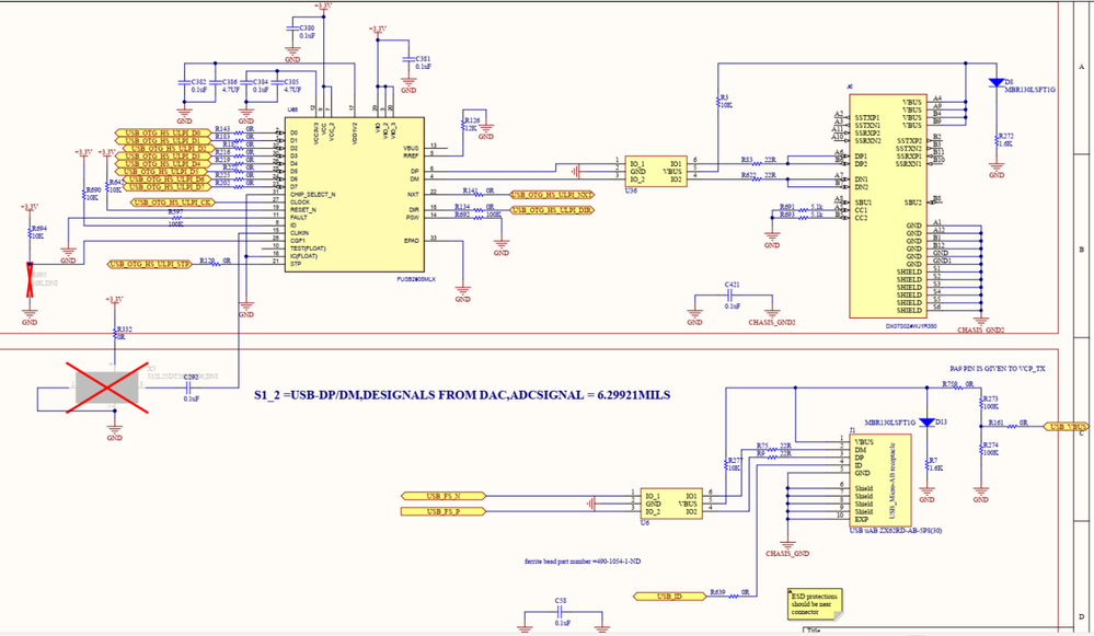

Please refer to STM32H7xxI-EVAL board schematic (page 8) which FS and HS USB configuration are enabled.
