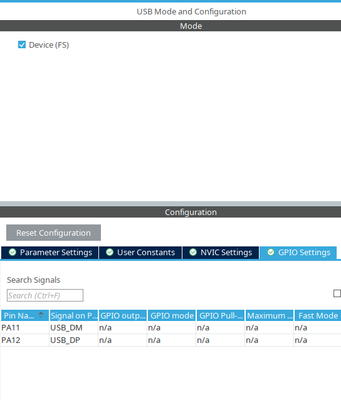

Ive enabled interrupts

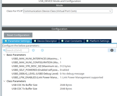

Basic parameters
Cant change anything about GPIO
Configured the middleware

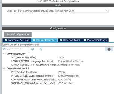

And descriptors

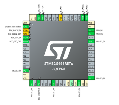

Theres not a whole lot running on there, and the pins look okay to me?

The NUCLEO-G491RE board doesn't have a USB port that is connected to the USB-DP and USB-DM pins of the STM32G491 (PA11/PA12).
The USB port on the top only gives a debug interface to program/debug the G491 and a serial port to communicate with the G491.
You can't create a CDC interface using that port.
