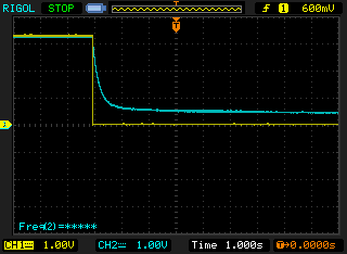

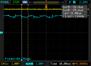

All my code is doing is transmitting a continuous stream of "U" characters, which I would expect to produce a square wave with a frequency equal to half the baudrate and an amplitude of 3.3 V. That's exactly what it looks like on the RX line when I send U's via RealTerm and probe between the MCU and the FTDI Basic. But when I probe the TX line, it shows a DC offset of about 2.20 V and an amplitude of about 0.24 V (Figure 1). Why?
I tried another test, disconnecting the FTDI Basic from the MCU. When MX_USART1_UART_Init() runs and initializes the internal pull-up resistor on PA9, the voltage jumps to 3.3 V relatively fast. But when I disconnect power from the board after this occurs and before main() runs, the voltage on PA9 gradually drops toward zero, as if there were a capacitor on PA9 (Figure 2). Repeating with the FTDI Basic results in the same effect, but with a DC offset of about 1 V.

}Blue is PA9 and yellow is PA10.
Figure 1: Transmitting "U" stream
Figure 2: Powering down from 3.3 V
Where is this apparent capacitance coming from? Is the pin fried? Do I have no idea what I'm doing? Any assistance would be greatly appreciated.

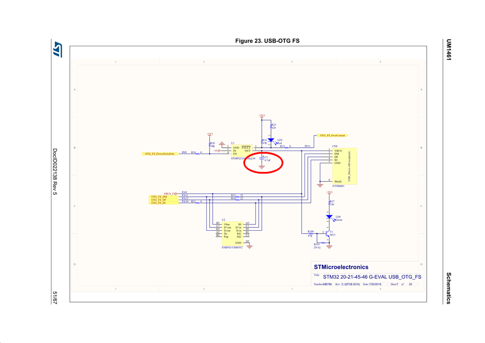

Perhaps review the schematic? Doesn't PA9 conflict with VBUS? And have 5V driven on it? Perhaps drive PH5 low https://www.st.com/content/ccc/resource/technical/document/user_manual/25/21/69/1d/13/c5/4e/c9/DM00036746.pdf/files/DM00036746.pdf/jcr:content/translations/en.DM00036746.pdf
2019-07-03 5:18 PM
In my setup I followed Table 20 of the eval board's user guide (UM1461), which says to "Remove USB cable from CN8" and "Remove R18" in order to disconnect from VBUS_FS.

Remove this capacitor.
This is a known problem, the same is on the 'F4 DISCO, and we've discussed it here since maybe 2013 or so, so I'd expect it to be already part of the manual...
