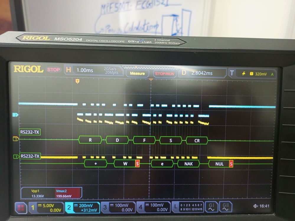

here is your scope image. The upper blue output of ST3232ECTR IC and i am getting what I wrote on putty i.e. RDFS
below yellow is the output from MOXA which is some gibberish data getting into input of the IC. You can clearly see the voltage levels written below left corner

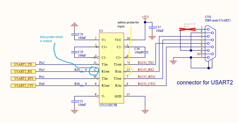

Without a wiring diagram/schematic I don't know what I'm looking at. The ST3232ECTR has 4 outputs, so I don't know what you mean by "output". Also I don't know your probe setting, so 200mV can also be 2V if you have a x10 probe. (That's a very nice scope btw. Not cheap. If your employer can afford that he can get you anything you need, in fact hourly rates exceed the price of many cheap tools anyway, so don't hesitate to ask your employer for things you need)
My recommendation: draw a wiring diagram on a piece of paper and see at which point in your circuit the signal voltage and/or timing isn't correct. Check ground connection, input impedance, supply voltage, reset/enable lines, etc. with a multimeter to see if there are shorts or open connections that shouldn't be there or parts of the circuit that do not get the right voltage or enable/reset levels. It shouldn't take much time.

the probe is at 1x and there is literally nothing in between as you can see in the schematics also i have looked at the board seems to be a straight line without anything in between. I even tried simulating the inside of the IC on multisim and got a result of 3.3V over there, why here i am not getting

If you haven't configured PA3 as an output and the level converter and the MCU are properly supplied, then R1out should be high or low. If your measurements are correct the converter IC seems to be broken.Try a different board.
2024-06-21 11:51 PM
PA3 is configured as input and i have checked the power supply via DMM it is 3.3V as it should be. on the board there are 2 of them and i have tried with both of the IC by changing UART1 to UART2 but i have seen no difference although if i transmit anything from my mcu to putty, that is properly transmitted and seen on the terminal. i don't understand how can 2 of the IC be broken and yet work on way properly but not the other way around that too half way i am getting data just not at the correct voltage level
2024-06-22 1:04 AM - edited 2024-06-22 1:06 AM
Obviously something is wrong as the IC has the right input and right power so it should get the right output. If the output is not shorted it should be the right level. Something is wrong with this development board. So I recommend either getting a new board or putting a level converter on a solderless breadboard and wiring it up to a different UART pin of the MCU. Or use a TTL level serial cable and avoid RS232 levels. It's not rocket science.
