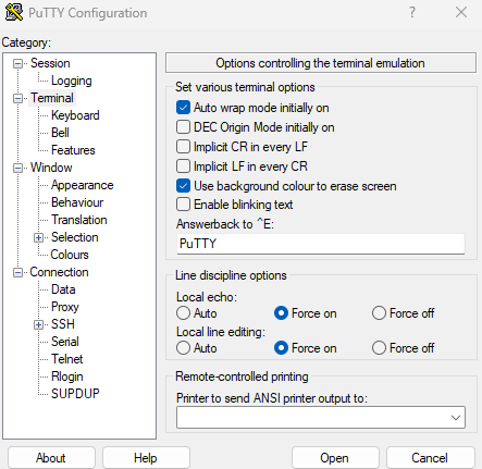

image of putty configuration for sending the data

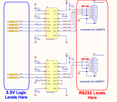

As noted in that previous thread, the stm3210e-eval board has RS232 Transceivers connected to the MCU's UART pins:
So you'll need to disconnect those before connecting your FL232RL ...

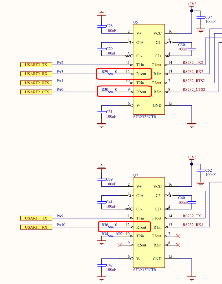

@Andrew Neil wrote:Are there not any links or solder bridges to disconnect them?
Yes, there are zero-ohm links on every output from the ST3232C chips to the MCU input pins:
