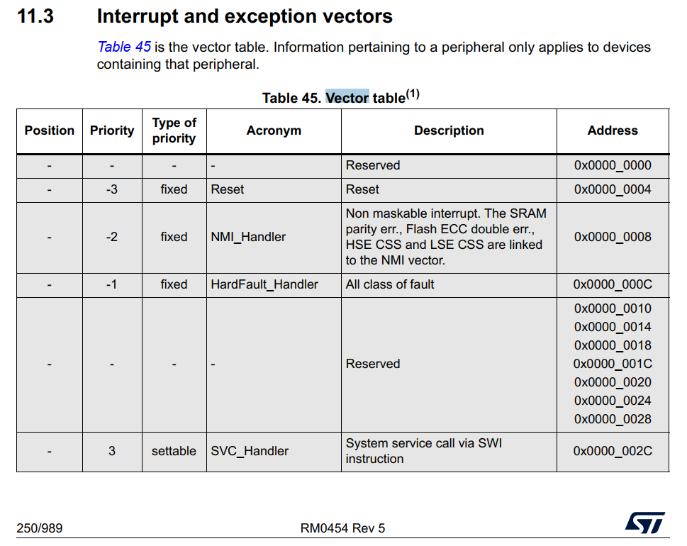

3) If you configure at least one any interrupt (I tried it from ADC, DMA, TIM), then something unknown happens. As soon as an interrupt should occur, the program jumps to >0x1fff0000 and stays there forever. Next, I spent a lot of time reading about how interrupts work. As I understood from the documentation:
There is a table of interrupt vectors. RM0454 Rev 5 page 250/989

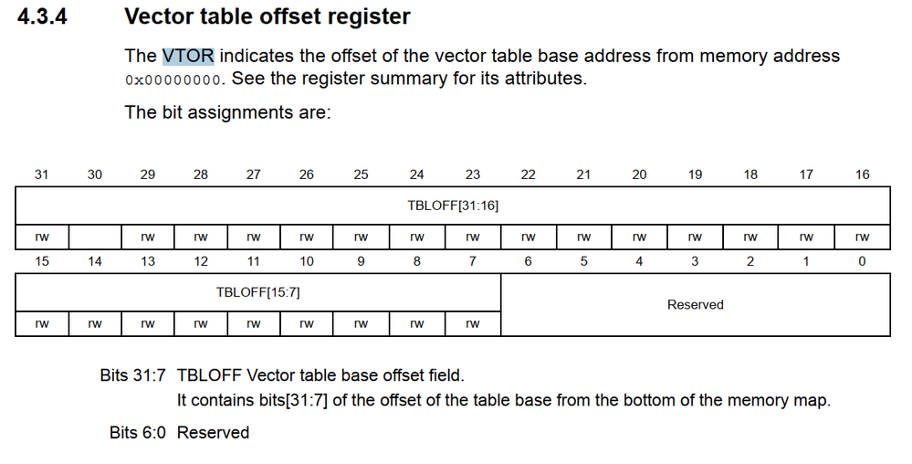

When and how it is written, I did not quite understand, but as I understand it, it is written to the address that lies in the VTOR register

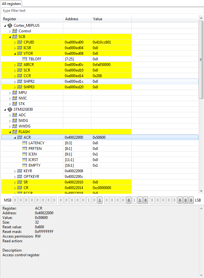

In the end, I put a breakpoint before starting the interrupt and looked at this register
I saw 0 there, which seemed strange to me ... It turns out that the addresses of the interrupt vectors are from address 0?

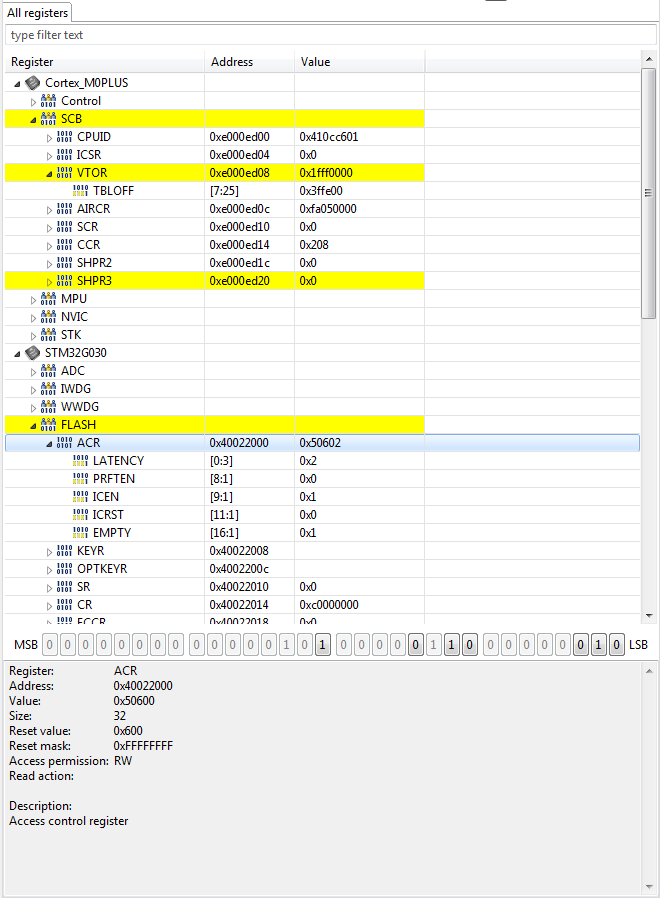

Next, I unpaused the program so that an interrupt occurred and also hung on the address space> 0x1fff0000, but if you pause in the VTOR register, it will already be just 0x1fff0000. Coincidence? Don't think. I also noticed that in FLASH the Latency register was set to 2. I don’t know what this is connected with, but it’s a fact.

Normally people set SCB->VTOR to the base of the vector table in SystemInit()
ST has this #define thing going on, I just tend to use the linker symbol directly, so the build tracks the linker script or scatter file, without secondary unrelated code changes.
The SCB->VTOR typically clears to zero at reset, but the mapping of memory at the zero address is controlled by the BOOT pins, so shadows the RAM, FLASH, or ROM at zero, via the bus decoding scheme. This allows it to boot from different memories, and immediate transfer control to the appropriate Reset_Handler.
The role of SystemInit() in ARM's CMSIS model is to bring up external memories, MCU, FPU, etc before C run-time code attempts to initialize the statics, ie copy/clear RAM, with initial data staged in FLASH
