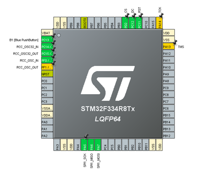

2024-11-22 9:16 AM - edited 2024-11-22 9:31 AM
1. I checked illustration in the STM32CubeIDE (see the picture below). There's a green LED called LD2 using that CLOCK LINE.
2. I can toggle the PIN as a basic GPIO.
