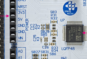

Later I found in the user manual (6.7 OSC clock sources):
"HSE, which is the 8 MHz oscillator for the STM32 microcontroller. This clock is not implemented on the STM32 Nucleo-64 board"
I have as well nucleo32-l432kc where the HSE seems to be present and working.
I'd like to just confirm - is the HSE crystal really not there? Or did I miss something?

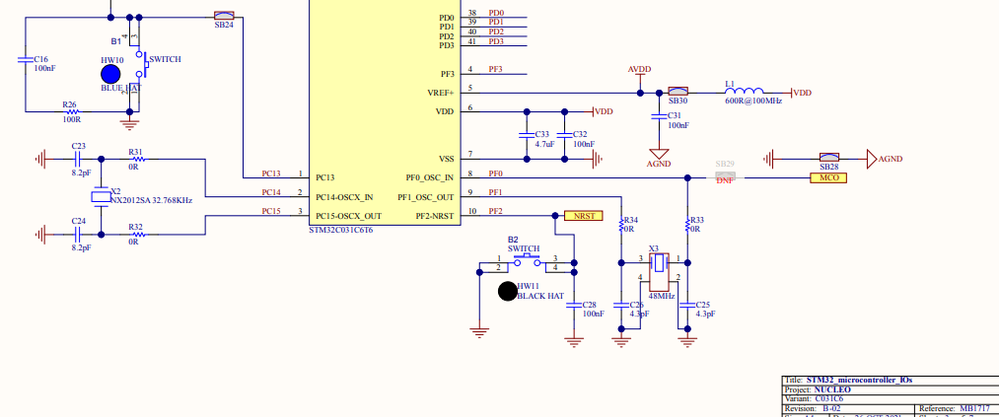

see circuit:
32k + 48M crystal should be there.
check it:
X2 + X3 .
But you have to set it to correct value in Cube , so set : 48MHz HSE crystal.

see circuit:
check it:
X2 + X3 .

Are you referring to UM2953 User manual STM32 Nucleo-64 boards (MB1717) M2953 - Rev 2 - November 2024?
Inspect the board and compared to the user manual.
