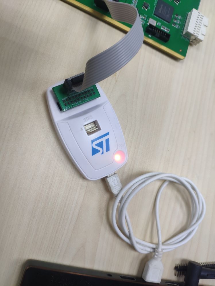

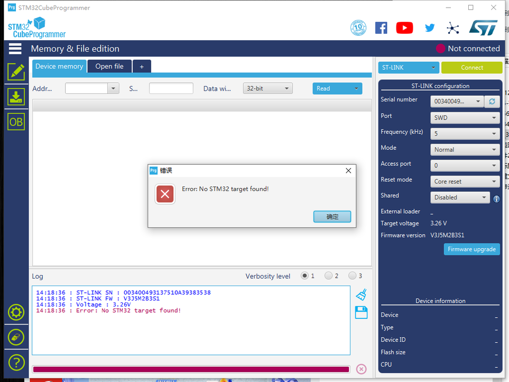

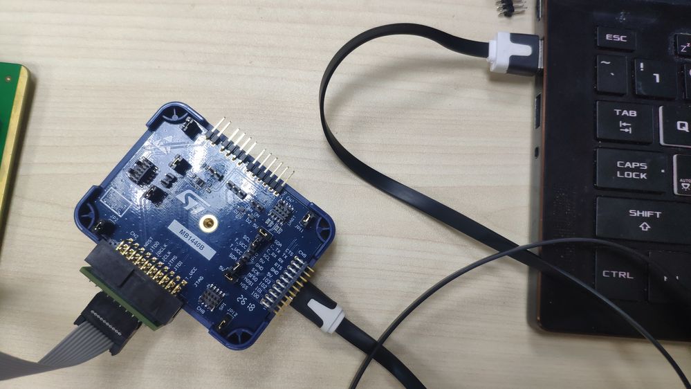

I can use the STM32CubeProgrammer to recognize the ST-LINK V3, but I can't connect to the STM32. I can connect back to ST-Link V2. Use the SWD mode. The ST-LINK V3 firmware is V3J5M2B3S1.Help�?
I used the logic analyzer to grab the SWDIO and SWCLK signals and found that the ST-Link V2 has a signal, but the ST-Link V3 has no signal.
this can conncet target
this cant conncet target

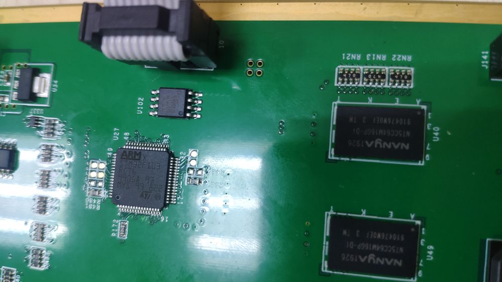

What exactly is the target?
2019-09-23 10:39 PM
My own board, STM32F103RCT6, and I also tried other boards, stm32f429

Try dropping the connection clock frequency.
2019-09-23 11:04 PM
I have already reduced the frequency to the lowest:tired_face:
