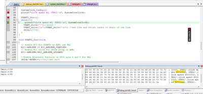

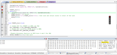

Had the same issue until tonight, experience C++ dev but newbie (4days) to STM32.
Anyhow, I managed to get the trace to run properly at 32MHZ thus far, after a cpl dozen failed attempts.
The Clock setting function: set the Clock speed to 32MHZ in the main example:
TESTED on STM32F411CE
VERY IMPORTANT: Be sure to test your clock speed settings: I figured I had the PLL_P value wrong !
And the ST documentation is not very clear on this value : I was after enforcing value 2 to have prescaler 2:
e.g. HSE to 25MHZ on STM32F411 then PLL_M prescaler set to 25 and then PLL_P to 2
Result 25/25 * (clock speed set value e.g. 192 MHZ) / 2 (PLL_P) == 96 MHZ clock speed.
However I figured I set, PLL_P = 2 , which caused the clock speed to be divided by factor 4 e.g. 192/4 instead of 2.
Instead again, it is counter intuitive but the PLL_P value needs set to binary b00 in order to obtain the desired prescaler to value == decimal 2.
So I was suprised that my attempts kept failing, after debugging, adding the SystemCoreClock  to a WATCH while debbuging, I figured it out, then simply setting the CPU speed, as below in Keil IDE Trace config settings, did the trick, so far tested 32 and 48 MHZ successfully.
Note: I am not even using an official STM32 Vlink but the Chinese cheap clone modified to expose the SWO pin. And well it works pretty well. See my post :
https://community.st.com/t5/stm32cubeide-mcus/debugging-with-itm-not-working-with-swv-in-stm32cubeide/td-p/172503
The correct clock speed code with correct PLL_P b00 value.

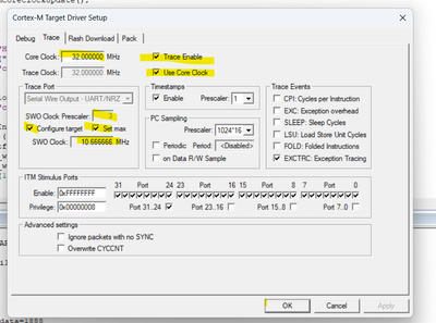

Keil IDE Debug trace config. I found that getting the clock option e.g. using the system clock, or SWO clock and then selecting a manual set/forced prescaler value or leaving it to "set to max" is what made the difference between scrambled characters and then clear output.
As below test done with 32MHZ
Keil IDE Trace debug config
Note: The prescaler for SWO is calculated by Keil IDE and is e.g. 3x for 32MHZ, was only 2x for 16MHZ, and for 64MHZ, just tested to work is set to 4x.
So to answer to S.C ST Employee: This is very important to enter the correct CPU clock speed and making sure one way or another than your IDE or whatever debug setup takes it into account and sets the right prescaler value for the SWO channel!

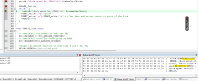

Update: TESTED to work at 48MHZ too, will keep testing see what happens, as below success
TESTED at 64MHZ again works 1st hand if right debug trace setting in Keil IDE.

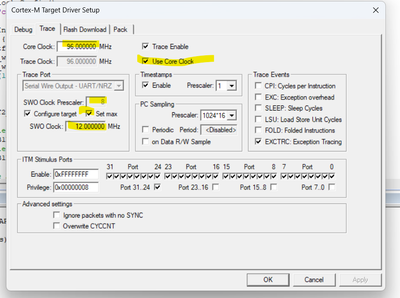

TESTED at 96MHZ again works 1st hand if right debug trace setting in Keil IDE. Which is 4MHZ away from the max 100MHZ for the STM32F411.
Again I cannot insist enough on the fact that you need to check that your debug IDE/setup is enforcing the correct SWO channel prescaler in order to limit the SWO freq to under 16MHZ. In this case thanks to letting KEil IDE setting it automatically to 8x, when at 96MHZ then it works perfectly !
Note you can set it manually, if your IDE does not set it automatically and just make sure to use under 16MHZ, I tested 10MHZ, 12MHZ and 8MHZ thus far to work perfectly.

Then I found that my Keil IDE trace settings were wrong namely that the Prescaler value for SWO needs to be set to a correct value.
1. in Keil IDE the automatic "set to max" setting seems to work well, e.g. tried 16,32,48,64 then 96 MHZ clock speed to see that keil IDE was calculating the right Prescaler for SWO, as screenshots in my reply below: the prescaler went up from 1,2,4,6 then 8 for 16,24,32,64 and 96 MHZ clock speed. Ended with 12MHZ SWO clock when on 96MHZ cpu speed.
Note: I tried setting this by hand it did not work ! The value needs to be i guess a specific fraction of your clock speed. e.g. 12MHZ worked well for 96, 10.666 MHZ did for 32 MHZ etc. screenshots below.
So clearly the .666 decimal value shows you need to enforce a specific SWO clock speed somehow. I could be wrong, it could just be some value under 12 MHZ that are compatible with the ST link. e.g. some values are not supported, some are. Anyhow Keil IDE gets it right or so it seems.
So I really believe that what happened in your case is nothing to do direclty with the clock speed being higher but your manual static limiting value being incorrect, with Eclipse / Cube IDE is I suspect "Limit SWO clock" does only enforce a manual value ( if im correct ?) vs Keil IDE having a nicer integrated auto algo to compute the correct value according to the cpu clock speed, If you get it wrong, it will not work.
