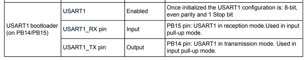

The H750 listens for a UART signal on PB15, unlike the H730. No way to change that. You may be able to tell the LCD to be quiet on this pin while the bootloader starts.
It may also be possible to transmit on the interface you want before the PB15 has activity. This may require some tight timing, but once the bootloader is active on another interface, it will stop listening on PB15.
The chip is entering bootloader mode, it's just that once PB15 has activity, it doesn't listen to the other interfaces anymore.

The boot loader looks for transitions on a number of critical pins/interfaces, described in AN2606, the loader is in ROM/OTP so it isn't going to change it's behaviour

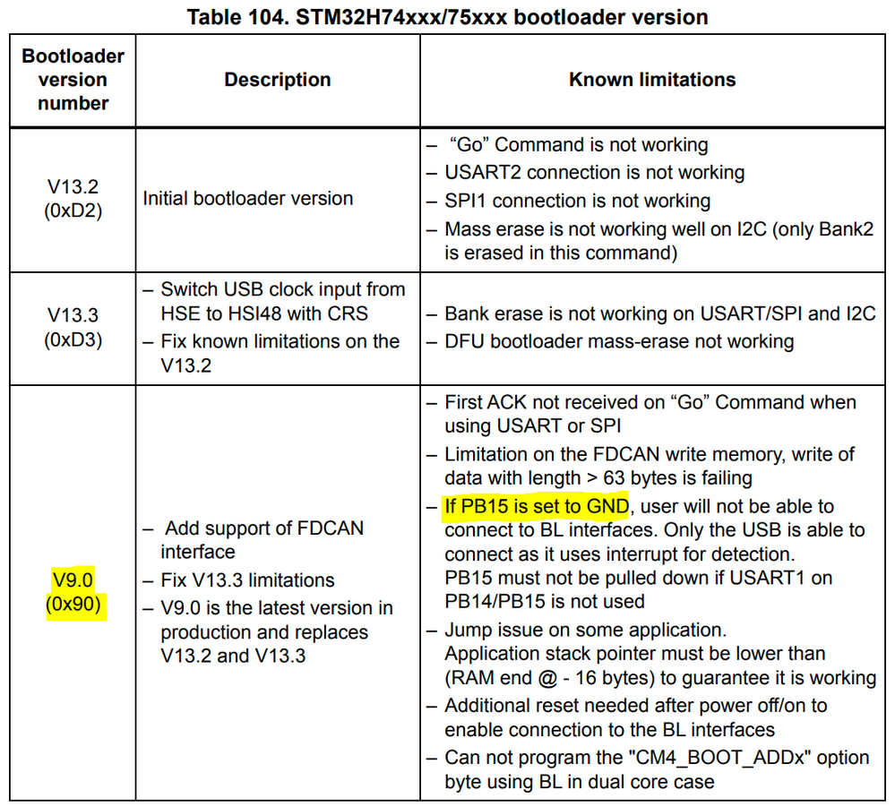

I went through it once more, and noticed that in the known limitations section, it mentions that if PB15 is grounded STM wont enter bootloader mode. The display does seem to ground the PB15 pin, so, in the current setup, a 750H will not work.
Thanks for your help.
I was under the impression that as i am using USART 2, it wouldnt effect PB15. However, that does not seem to be the case.
I guess the best option for us would be to use another pin instead of PB15.

I read that too and thought it was only for a very early version of the bootloader. Rereading this, it seems v9.0 is the newest version and that v13.x are earlier versions. What a weird versioning scheme.
