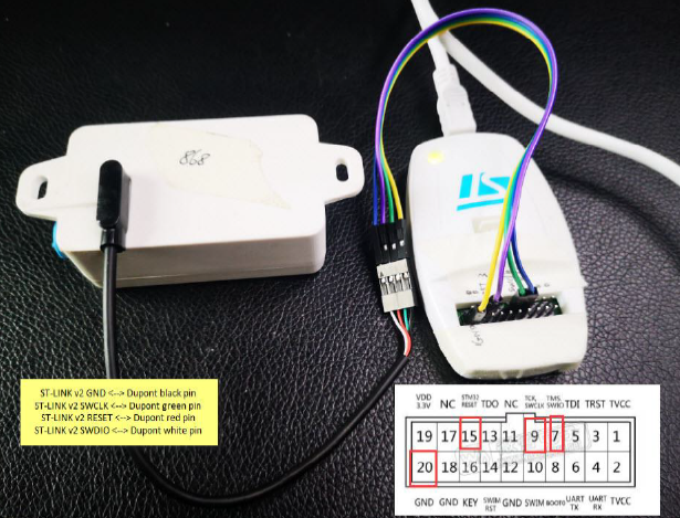

I'm connecting it to a Dragino temperature sensor, which is battery powered. The sensor is on and reporting data so it is not a power issue.

I connected it according the pinout instructions given to me by the manufacturer (Pins 20, 15, 9, and 7 to their respective pins, per the instructions given b Dragino. See attached photo). Also connected pin 19 to pin 1.

Might want to try a lower clock speed. You can try to connect under reset as well. Connections look okay.
