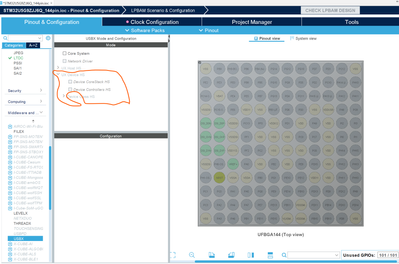

I tried to create a new STM32 project that will implement USB device and LTDC base on MCU chip STM32U5G9ZJJ6Q, the 10mm x 10mm option of U5G. Yet, when I am not able to configure u5G to be high speed usb device. The option is in grey color. Please see screen shot below.
I don't use many IOs. USB high speed port, DSI one lane and I2C for touch panel and addition 4 I/O signals are needed only.
Please let me why I can't configure the USB.

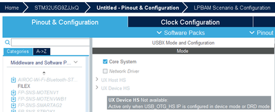

Hello @Kelly3
You can enable USBX device HS, when USB_OTG_HS is configured (in device mode or DRD mode).
Also, HSE clock source must be enabled.

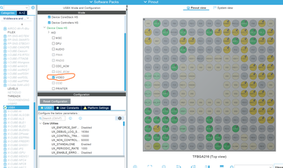

Imen,
In the Device Class Hs list, there is "Video" option. Is this for U5G to receive video from host, or is it for send video to host?
If it means to send video to host, which device class is better choice for application that receives video from host and forward received video to LCD display?

Hi @Kelly3
Your config is correct as you need to configure your target in Device Video mode, and you should select video class in USBX stack.
