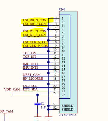

Refer to the UM3300 Rev1.0 table 19. Camera module connector (CN14) pinout and the Nucleo connector CN6 schematic.
There are some changes to perform on the drivers to be made on the I2C instance and GPIOs, and also GPIOs for ToF, IMU and PWR, They are not the same between the two boards.

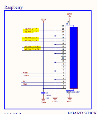

We were trying to interface the below image sensor(monochrome only) kit with STM32N6.
https://www.st.com/en/evaluation-tools/steval-56g3mai.html
STEVAL-56G3MAI is looks like intended to designed for Raspberry pi compatibility, unfortunately Raspberry pi V5 schematic not added in their official portal to check the FFC pinout details.
N6 22 pin FFC
My queries are, The STM32N6 Nucleo camera interface(22PIN FFC connector) is compatible with STEVAL-56G3MAI?
looks like the MIPI data and clock polarity(P&N) are interchanged, may be intended design for raspberry pi.
Is there a way that we can interface STEVAL-56G3MAI with N6? or we must design our own camera modules PCB to make compatible with N6?
2025-01-23 5:48 AM
Hello @Madhu_S
I fear that the J2 connector in the schematic of STEVAL-56G3MAI shows differences in connection at the polarity level of the CSI DxP and Dx_N signals. What is strange is that it also does not correspond to the official Raspberry pinout.
https://www.arducam.com/raspberry-pi-camera-pinout/
I cannot answer you, if you try to connect as is, you will surely damage your boards.
