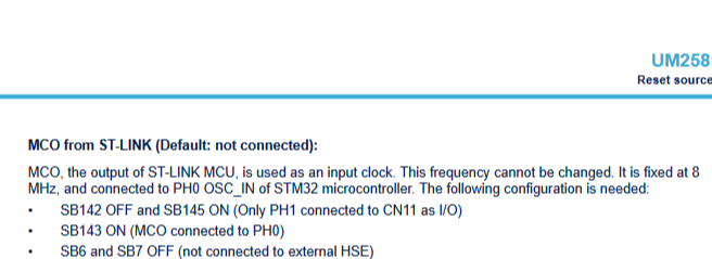

@krook wrote:it is not clear to me from reading the user manual from where I can fetch ST-LINK MCO. What physical modifications do I need to do?
From the extract @Chris21 posted, these are the settings you need:
"Off" means that there is no connection across the solder bridge - the bridge is open;
"On" means that there is a connection across the solder bridge - the bridge is closed.
(look like they forgot that this is just a solder bridge and not a jumper link - where the jumper would be literally on the pins, or off them)

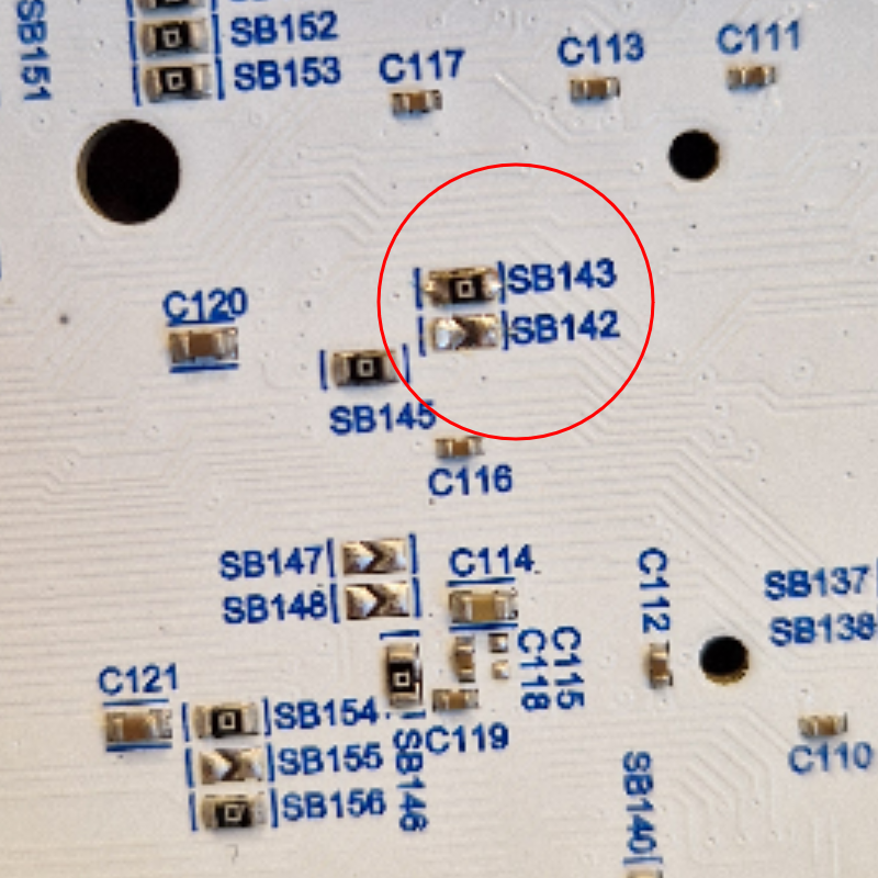

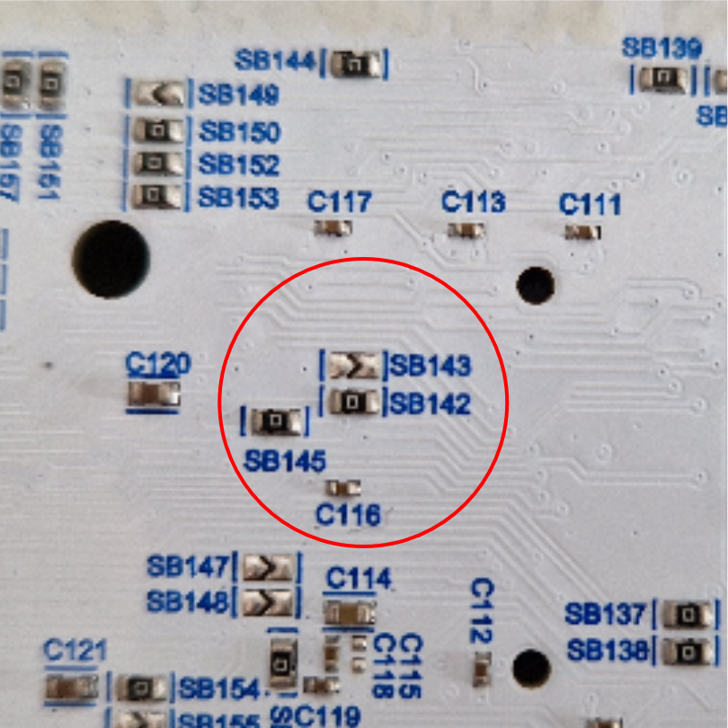

I've made the necessary changes, and turn on SB143 while I've turned off SB142. However, I must have done something wrong as the HSERDY bit still never is set. Hopefully the error now is simply a software error. The code I am using to try and use the ST-LINK MCO follows
Here is a picture of my modified board
Any idea what my likely error is now? I can't remember what, but something gave me the impression that the ST-LINK MCO would appear as HSE. @Andrew Neil @Chris21

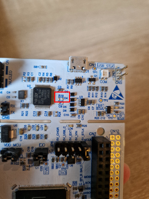

It looks like you have done the correct things with the hardware and software.
I wonder about R19 on the ST-LINK:
It looks like that would need to be present.
2024-10-12 7:07 AM
@Chris21, that does indeed seem relevant. May I ask where you found this diagram? For my own future reference in trying to figure these things out.
When I look at my board, there is indeed what I interpret as an OFF solder bridge there. I believe that I should put another 0-Ohm resistor there to make the current be able to pass. This was less obvious to me as R19 was not mentioned in the two documents I looked in. It makes sense that this detail should be found in the ST-LINK documentation, but I only considered that my STM-board was misconfigured.

I was going to add a question, what does 100R mean? It is stated next to R19 in the diagram @Chris21
2024-10-14 7:38 AM
The schematic for the board is on ST's web site: https://www.st.com/en/evaluation-tools/nucleo-l552ze-q.html, click on the CAD resources tab.
100R denotes a 100 ohm resistor, but 0 ohms (or a bit of solder) should work.
