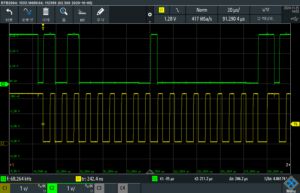

figure-1 I2C waveform with STM32L433rc-p Nucleo board.

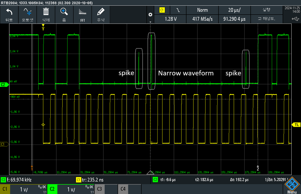

When I try to use STM32L433RC-P Nucleo's I2C for communicating with AT24C01 I2C EEPROM, two strange waveform occurred. This strange waveform is not occurred from another model STM32 MCU.(example. STM32G0xx Nucleo board. See below figure.2.)
1. It makes strange low level spike.
2. It makes strange and very narrow I2C waveform compared to other STM32 MCU devices.

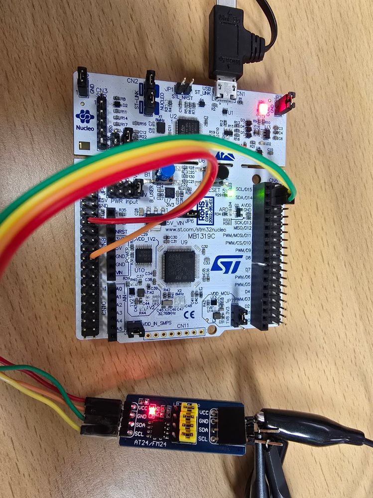

The spikes may be consequence of crosstalk (too long SDA/SCL close to each other) or improper ground/return arrangement. I hope you are not attempting to use jumper wires and solderless breadboards.

You haven't said what pins you're using for I2C.
Show a schematic of your setup.
Some good, clear photos may also help.
Have you checked the board's User Manual and/or schematics to see if there's anything else on those pins?

1. connect Nucleo L433RC-P board to AT24Cxx test board with jumper wire.
- You can buy AT24Cxx test board from this site. https://www.waveshare.com/at24cxx-eeprom-board.htm

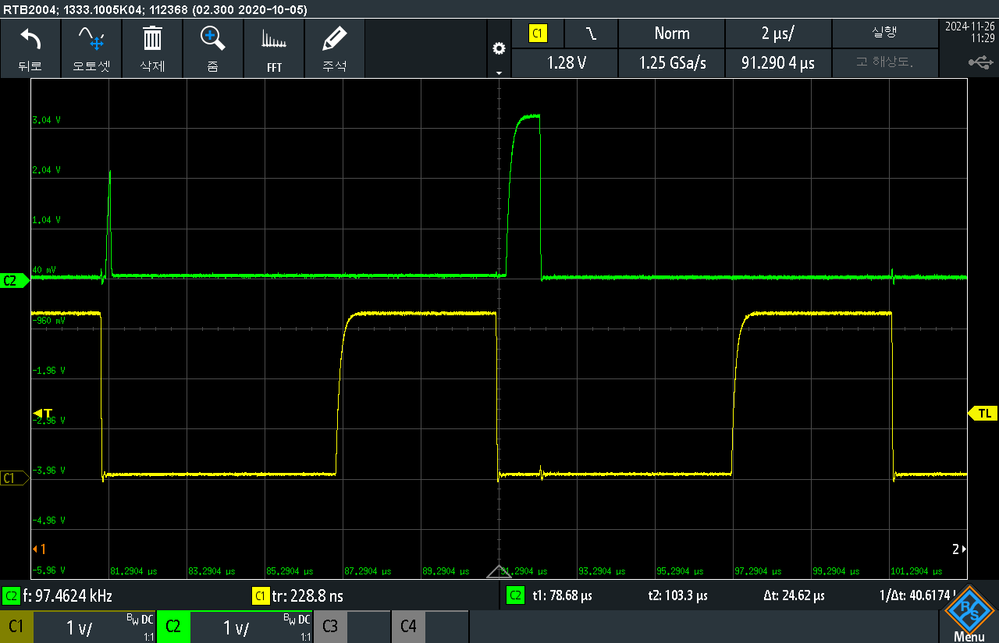

I added additional detailed waveform below.

I realized that this is a normal waveform and depends on particular circumstances such as clock speed, slave's speed etc.
Thing is, that I2C shifts out (changes output) SDA at falling edge of SCL and samples (shifts in, reads) at "rising" edge. More precisely, during the SCL high period. Quoting from the I2C spec: "The data on the SDA line must be stable during the HIGH period of the clock." During SCL low, any changes are allowed.
In this case, the first, shorter peak happens just after the 8th data bit, i.e. master (in modern I2C parlance, "controller"; here: STM32) releases SDA and it succeeds to rise high enough to be noticed when the slave ("target", here: EEPROM) pulls it down to signal ACK. And the next, longer pulse, is after slave releases ACK upon the next shift clock edge, and before STM32 pulls SDA down because of the MSB of next byte is 0.

2024-12-11 12:43 AM - edited 2024-12-11 12:48 AM
Yes, there is a possibility that SDA edges will cause spikes on SCL (e.g. due to capacitive coupling, or due to inadequate ground arrangements). So the possibility for that is not zero.
However, there are several things which mitigate this - to certain extent:
- as SDA must not change during SCL high, SDA changes occur when SCL is low, i.e. when SCL is actively pulled down thus SCL is low impedance at that time (exceptions are the START and STOP conditions)
- you as the designer should use an adequately "strong" pullup on SDA/SCL to ensure adequately low impedance in the high state, depending on tracks capacitance and mutual capacitance; also, the ground arrangement should be adequate for given signals
- I2C drivers should have controlled impedance, i.e. they should have (in STM32, you should choose adequate GPIO_OSPEEDR setting)
- I2C receivers should have implemented forms of noise rejection, see analog and digital filter in STM32 I2C, and also the timing settings should reflect the bus setup (RC constants) so that e.g. SDA edges occur when SCL is certainly low. Note, that requirement for noise filtering is part of the I2C specification (although to certain extent optional, or as a recommendation), and external I2C devices implement it in different ways, see datasheets of those devices.
