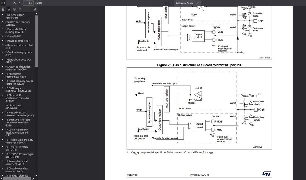

Reference manual RM0432 p. 334, fig. 26 shows 5V tolerant pins, there's a protection diode to VDD_FT.
AN4899, on p.9 says: "The voltage level called VDD_FT in some datasheets and reference manuals is inside the ESD protection block"

So FT Pins have no direct connection to STM's VDD, correct? But there's a protection diode from such a pin to VDD_FT? Where does VDD_FT connect to? How does schematic associated with it looks like?

VDD_FT is only internal, not connected to any accessible pin

usually on cmos circuits you have protection diodes to vss and vcc on the chip, to keep the mosfet inputs alive . so this is the limit for input voltage.
now if you want some "tolerance" to higher input voltage, just leave away the protection diode to vcc (+) .
and to get some minimal protection against ...maybe static voltage, replace the diode to vss with a zener-diode ; so you limit the input to (vss - (diode forward)0.5V) and (vss + (diode reverse break) 8V ) .
now you got a "5V tolerant" input. not so difficult... :)
