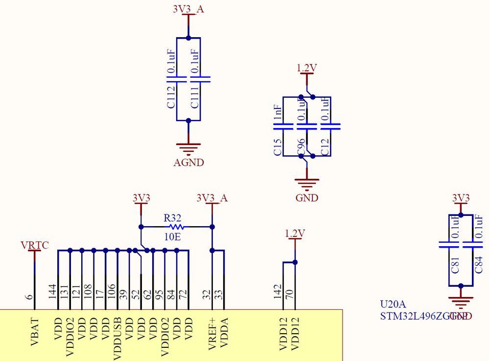

As said by @KDJEM.1 refer to the hardware getting started.

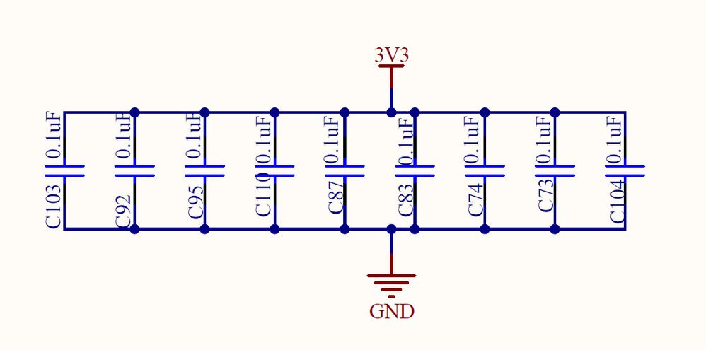

Check the decoupling capacitors: did you mount all needed capacitors on VDDx?
Check your connections, MCU soldering etc ..

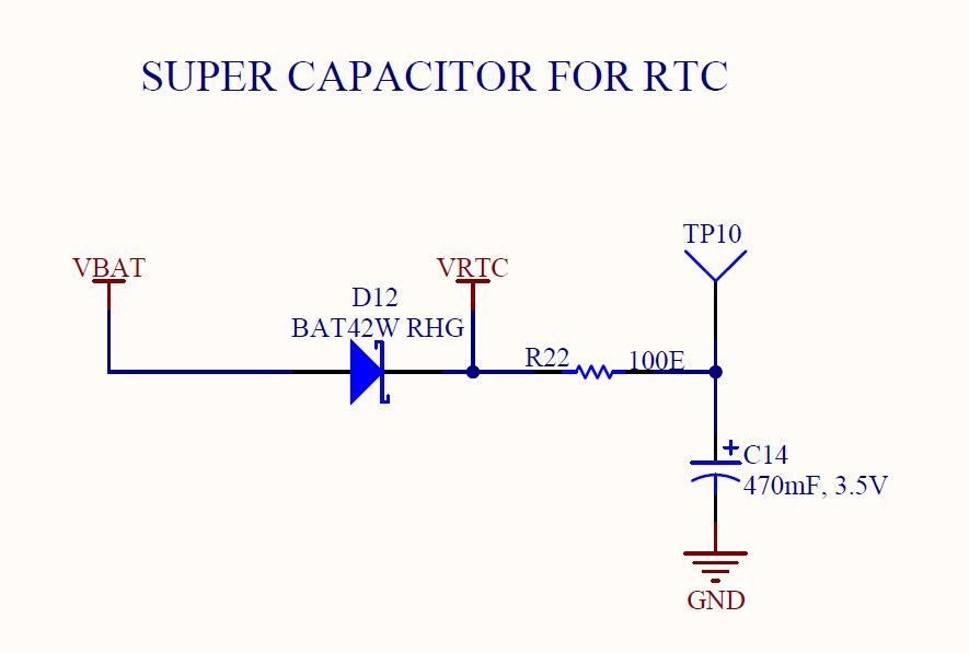

2023-12-20 2:35 AM
Thank you for the answers.

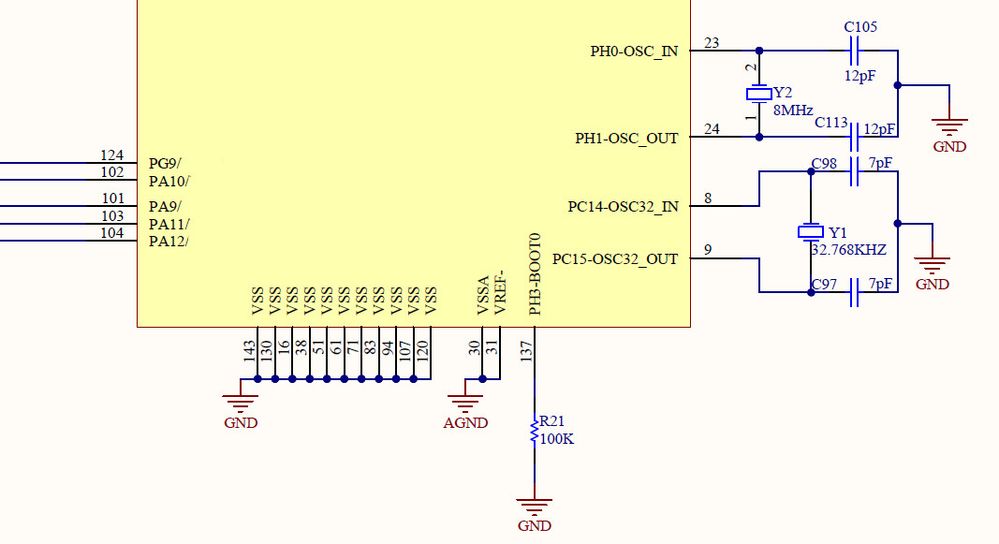

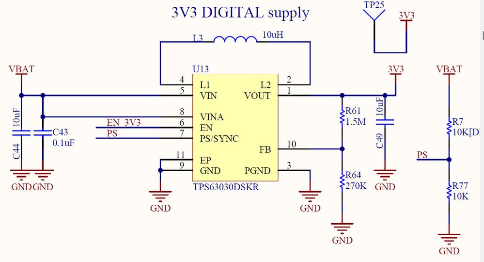

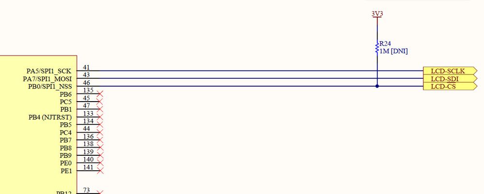

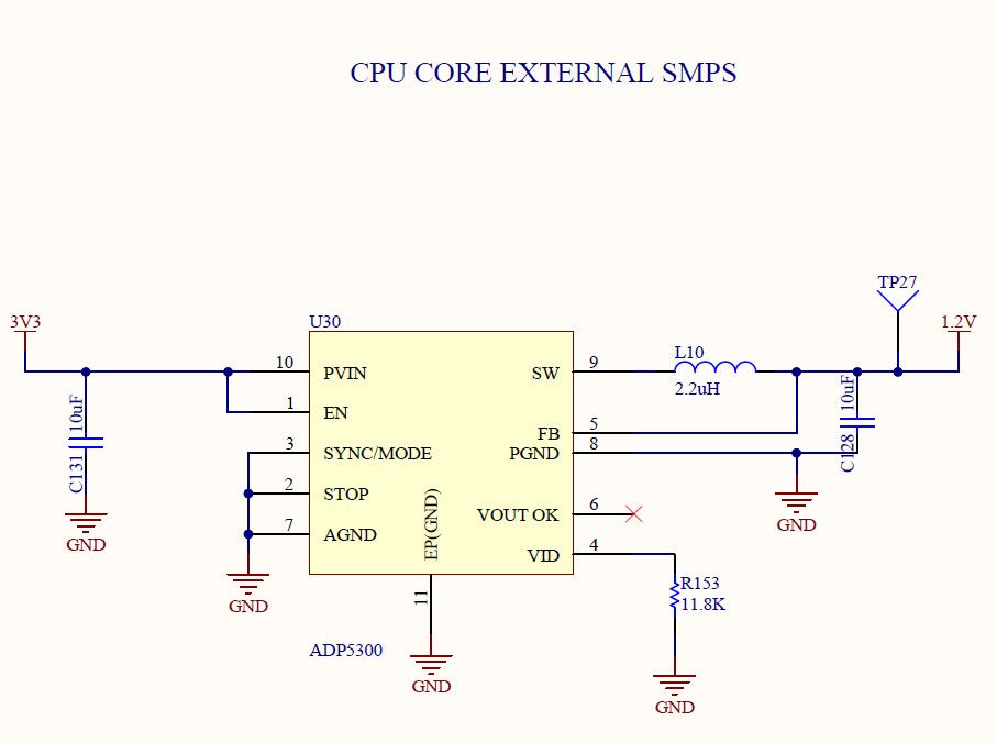

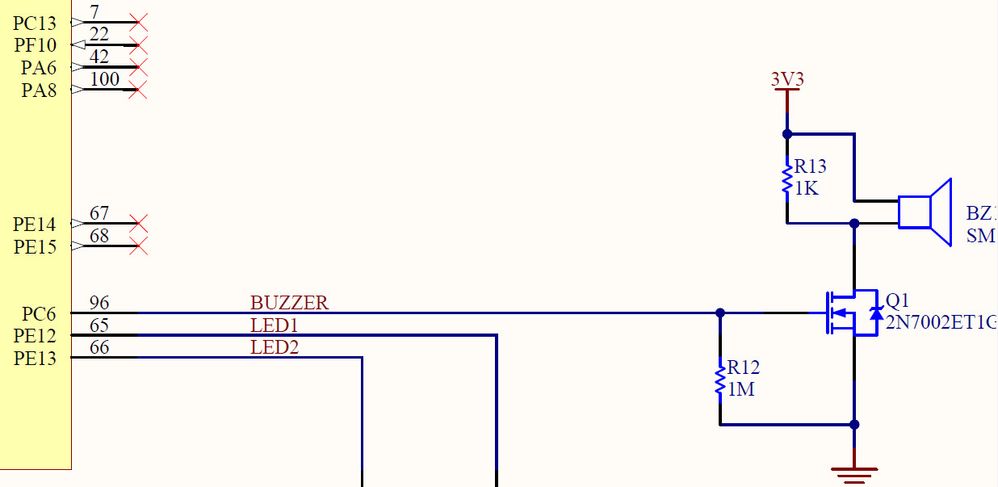

I share some screenshots from my board.
After the power on, the board power on the buzzer and the display...but sometimes is all off and Vdd is 3.3V.
I'll check again the soldering issue.
