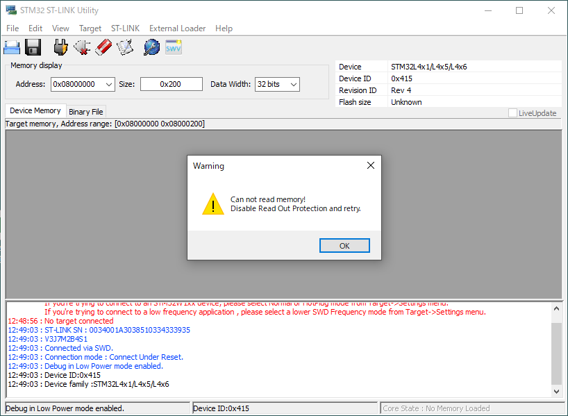

I have created a prototype board using STM32L476RE.
Then I did "Target" > "Connect" in ST-LINK utility, but I got the error as shown in the picture.
I do not know the cause and solution.
I did a lot of research on this site and checked the following, but there was no problem.
The power supply is 3.3V to VDD, VDDA is connected to VDD with ChipBias, and has a 0.1uF passcon.
VSSA is connected to GND via a 0805 size 0ohm resistor in the vicinity of VSSA.

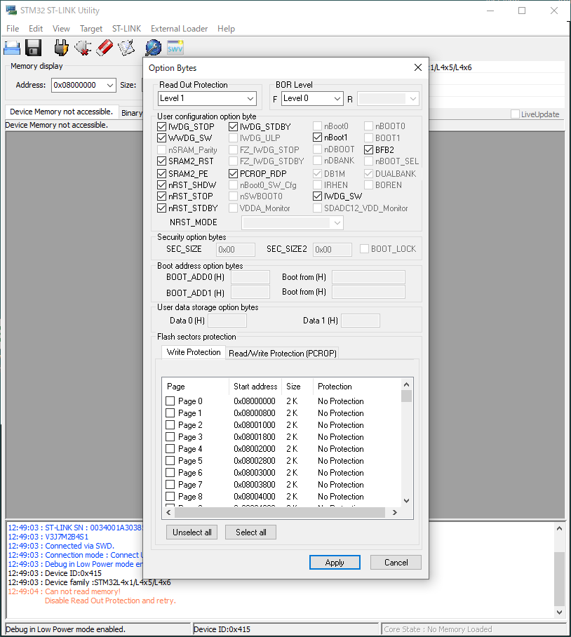

I tried to change the "Read Out Protection" from "OptionByte" to Level0, but I couldn't do it. Also, when I select "OptionByte", the display is very slow and appears on the screen after about 5 seconds.

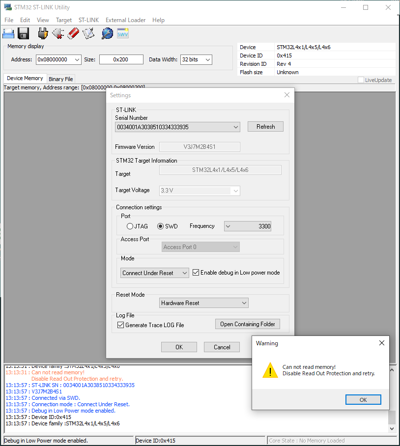

I tried to change the "Reset Mode" to "Software System Reset" from "Setting", but I could not change it with an error.
What else could be wrong with this phenomenon?
I would appreciate your advice.

I tried everything, but even if I programmed the PCROP protection option byte as follows, I got an error and could not write
PCROP1_STRT = 0xffff
PCROP1_END = 0x0
PCROP_RDP = 1 (checked)
PCROP2_STRT = 0xffff
PCROP2_END = 0x0
When we prepared another prototype board for verification, the other board was able to recognize and write data without any problem.
We concluded that the microcontroller on the board in question was probably faulty.
