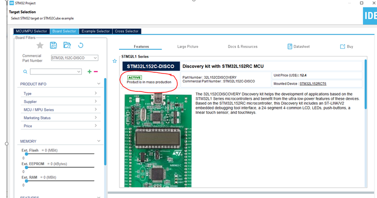

The development board I'm using is not obsolete:

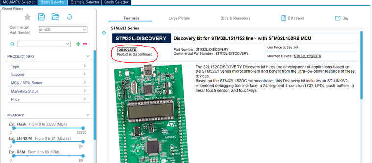

Maybe you're referring to this other board, same appearance, but with a different microcontroller:
The library I mentioned is for the old board, and the old ST IDE, called SW4STM32. That's why I'm asking for examples or test programs for the new board, that work with the new ST IDE, CubeIDE.
