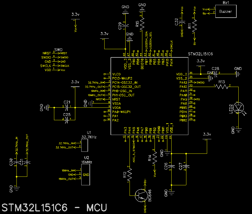

I'm facing an issue while trying to program STM32L151C6 using STM32F4 Discovery board as programmer. What I did are the following:1. I removed CN3 jumpers from STM32F4 Discovery board page 14 in [][1]2. I connect NRST, SWDIO, GND, SWCLK, Vdd to my target STM32L151C6 SWD pins except SWO ( I kept it floating)Pin:number CN2 (STM32L151C6) Pin:1 Vdd Pin:2 SWCLK (PA14) Pin:3 GND Pin:4 SWDIO (PA13) Pin:5 NRST (NRST) Pin:6 SWO (No Contact)
3. I used STM32 ST-Link Utility V2.2.6 to test SWD.The result is ''Cannot connect to ST-Link''I've attached the schematic for my circuit design.I really appreciate your prompt help guys to facilitate this issue.2015-03-17 3:41 PM

Hello alharthi.waleed,
I'm using the ST-Link/V2 myself on a custom PCB and it works fine.Your SWD setup looks correct except for one part that makes me suspicious:VDD->VccThe SWD interface does not provide means to power the MCU, but it does take the MCU VDD as an input. You need to provide a power supply for the MCU from elsewhere (as you wrote, you use a battery).Not sure what Vcc voltage is since you run it over a resistor, but the SWD VDD should be connected directly to the MCU VDD (3V3).From the ST-Link/V2 documentation:''The power supply from the application board is connected to the ST-LINK/V2 debugging and programmingboard to ensure signal compatibility between both boards.''Here is some documentation on the ST-Link/V2 (check out p. 12):http://www.st.com/st-web-ui/static/active/en/resource/technical/document/user_manual/DM00026748.pdf2015-03-18 7:07 AM

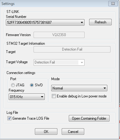

Hi Daniel,
I've checked the power and it's fine there is no drop in voltages however once I tried to connect with STM32 ST-LINK Utility with the below configurations:2015-03-18 7:09 AM
You would only need to connect the GNDs between two independently powered systems.
I'd look at the firmware on the ST-LINK, and check if any of the solder bridges related to NRST, etc need to be removed from the DISCO board.2015-03-18 7:15 AM

That's for the stand-alone ST-LINK/V2 which has buffering chips between the signals, the DISCO board implementation has the signals come directly out the F103 to the pins. In this context the power is derivied from the USB supply and feed to the target board, if the target board is self powered at 3.0 or 3.3V the signal levels will be compatible, and a common ground provides a path for the current/electrons.2015-04-08 12:18 PM
First of all I would like to thank each one of you guys. I found the problem which is related to the STM32F4Discovery board I was trying to use it as a programmer. but there were issues not easy to grasp in order to modify the disco board.
What i've done was that I bought a new ST-Link-V2 and it works like charm :) without any changes to the circuit design.
