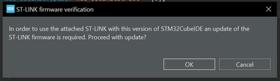

I can't debug my program on my STM32L1 Disco because of the attached message.

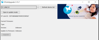

This in itself is not the problem, the problem is that I can't auto-update because it doesn't know what firmware is installed on the board itself!
What can I do or what am I doing wrong?
I am using the latest CubeIDE (1.16.1).
Thanks in advance, you are my last hope.
Best regards.
Johannes

What happens if you click 'Open in Update Mode' ?
Does STM32CubeProgrammer do the same?

Disconnect and reconnect your USB cable and try again.
Did you try with ST-LINK firmware upgrade tool?

It used to say that the card was not in configuration mode. I reset it and rebooted, but did not unplug it. When I unplugged it, it worked. I did the upgrade, wrote a little test program and it works.
Thank you very much.
