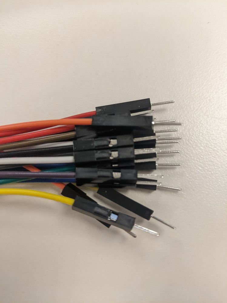

I admit that I feel like I'm missing something obvious here, but I am using the STM32H7B3I-EVAL evaluation board and they have 0.05" pitch header pins for some of their connectors (CN5/CN6). I am trying to source a single position connector that can connect to their header pins (P/N: FTR-130-53-L-D-LC).
I am looking for something similar to the image below, but 1.27mm (or 0.05") pitch and female.
I want single-position so I can send various GPIO signals to different boards. Is anyone aware of a product that can do this?

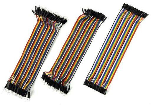

Sure, there are a lot of them in the internet shops with male-female combinations, e.g. like this one:
Does it help?

Hello Peter,
Yes, something like this would work perfectly, I just need it to match the pitch of that connector (0.05" pitch). I've found 100's of ones like the picture you provided, but they're all 0.1" (or 2.54mm) pitch. Can you link a specific one by chance?
2022-11-07 8:07 AM
Oh, that's right, I hadn't read correctly and assumed 0.1", sorry.
No, I haven't seen such plugs in 0.05" yet, but maybe someone else in the community?
Good luck!
/Peter
2022-11-08 6:54 AM
Bumping this.
Is anyone else aware of single-position pins like the picture above that are 0.05" pitch? I need to send those signals externally from the evaluation board and do not currently see another method to do so.
I do find it hard to believe that STM put a connector with no mating product... There must be something.
