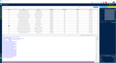

I need your support to resolve an issue with the STM32H7B3.
Today once I connected the board to my PC; I noticed that nothing pops up in the display;; I mean... black screen.
But ... I can see the green lights over the board on and I'm able to connect it thru the SMT32CubeProgrammer
here is an Image:
is connected.
What can I do to see graphics over the display?
Thanks in advance and your support
2023-07-20 2:20 PM
Your screenshot shows that the FLASH is erased (0xFF). That means there is no program on the board, so nothing is sending data to the display.
Is this a STM32H7B3I-DK? You can re-flash the demonstration firmware if you can find it. I can try to look...

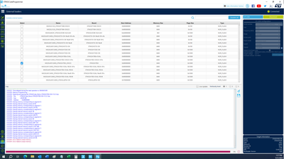

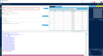

Hello Again @TDK
I did the step; the re-flash, but looks like there is a problem once STM32CubeProgrammer try to delete the external memory
in the next image; you can see that... I'm trying to upload the demo.hex
and I have as External loader the one which is in the next image:
In resume: the problem is when then CubeProgrammer is trying to delete External Memory
