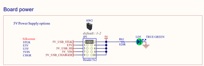

Additionally, I’ve noticed a low and unstable voltage to the board. When monitoring the target voltage in CubeProgrammer, it fluctuates between 0V, 0.22V, and 0.35V what caused I think the faulty red led LD7 to lit up and the green led LD5 to lit poorly. This instability could potentially be contributing to the issues I’m facing, as I am no longer able to connect to the board through ST-LINK, I get No STM32 Target Found.

Apparently the problem was in ST-link last firmware update, I was using a usb charger cable and the jumper was switched on STLK whithin the 5V power supply options. Before the update the board was working fine, After switching the jumper to CHGR 5V_USB_CHAGER the board powered up and worked fine but the MCU was getting too hot I don't know if there is still a short circuit, whether it is damaged or an issue that ST should fix in the coming firmware update.
