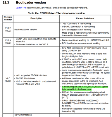

Hello @m.beddi,
You may need to check bootloader version. It is possible that you cannot program the "CM4_BOOT_ADDx" option
byte using BL in dual core case. Check *STM32 microcontroller system memory boot mode - Application note.

Hi @FBL,
thank you for your answer.
Do I need the CM4_BOOT_ADDx option when writing my own bootloader or is this only necessary for the ROM built-in bootloader?
My bootloader is supposed to fetch the data from SD card and write it to flash, I haven't figured out yet how the system bootloader can do that. Is that also possible?
Or do I still not quite understand something? My procedure would now be as described in my answer to ramprakash08. Will I have a problem with this procedure? Thank you.
