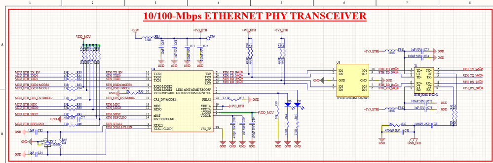

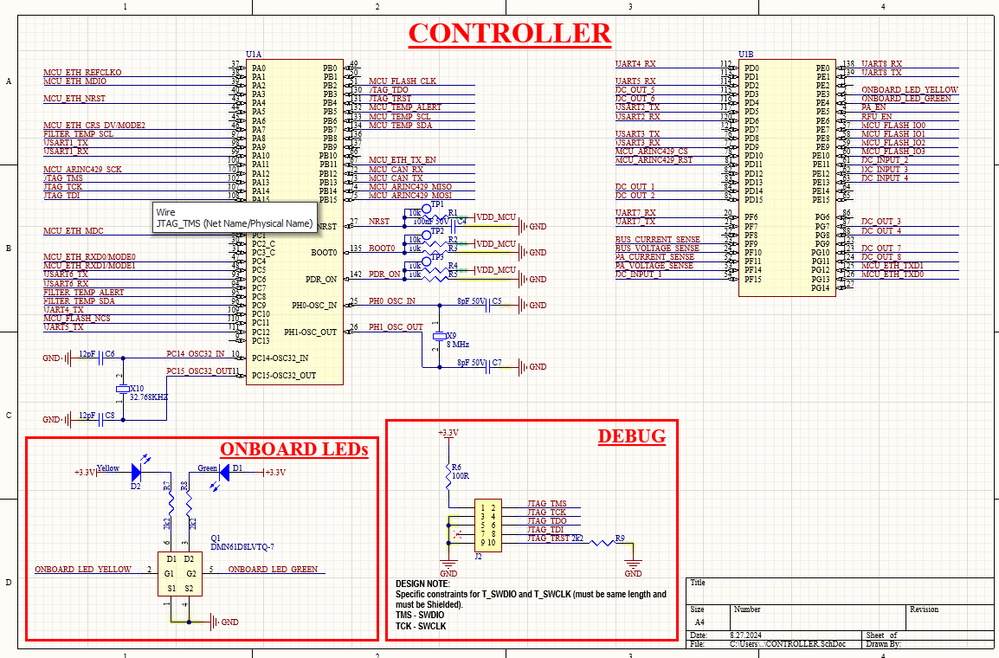

I am trying to run an ethernet phy (LAN8742Ai) using STM32H745. I can say that there is no major difference from the Nucleo ref. phy design. However, when i ping, i cannot get a response and the processor gets very hot. The phy and MCU blocks design as follows.
Thank you.

When you say the MCU gets very hot, is it restricted to that specific application? what if you toggle a GPIO? do you have the same behavior? As could be something linked to the power settings/clock settings or power issue in the HW.

Hello @KTVT ,
After a first examination of the published design here are some findings:
the GPIO configuration is not the same in fact you use:
PG 12 ------->ETH_TXD1
and the ref design of nucleo uses the following pins:

> regarding the high temp issue, you are motioning we need some more insights
Will the STM32 become hot if you don't enable ETH and PHY and instead run something else (LED blinky)?
