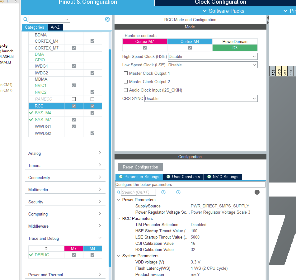

can any one tell me where should i define i am using an internal clock
below, do i need to ENable HSE or LSE or CRS SYNC?
