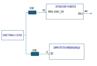

Corrected, but we are using ETH in RMII slave mode then in that case PA1(44) can be left open right?
2025-07-03 4:51 AM
NO, the RMII Block in the STM32 need the RMII_REF_CLK!

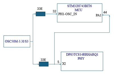

Is this correct?
2025-07-03 6:23 AM
YES!
For EMC reasons, i would put a 3. resistor from OSC50M to PA1, but this dipends a lot on the PCB Layout (Track impedace an length).
like this:
OSC50M -> resistor -> PH0_OSC_IN
OSC50M -> resistor -> PA1
OSC50M-> resistor -> XI
